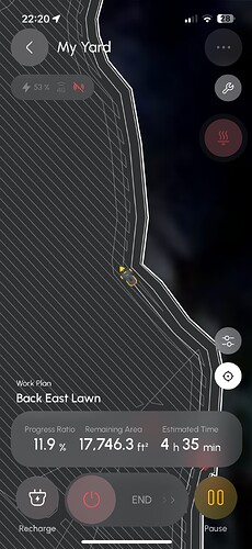

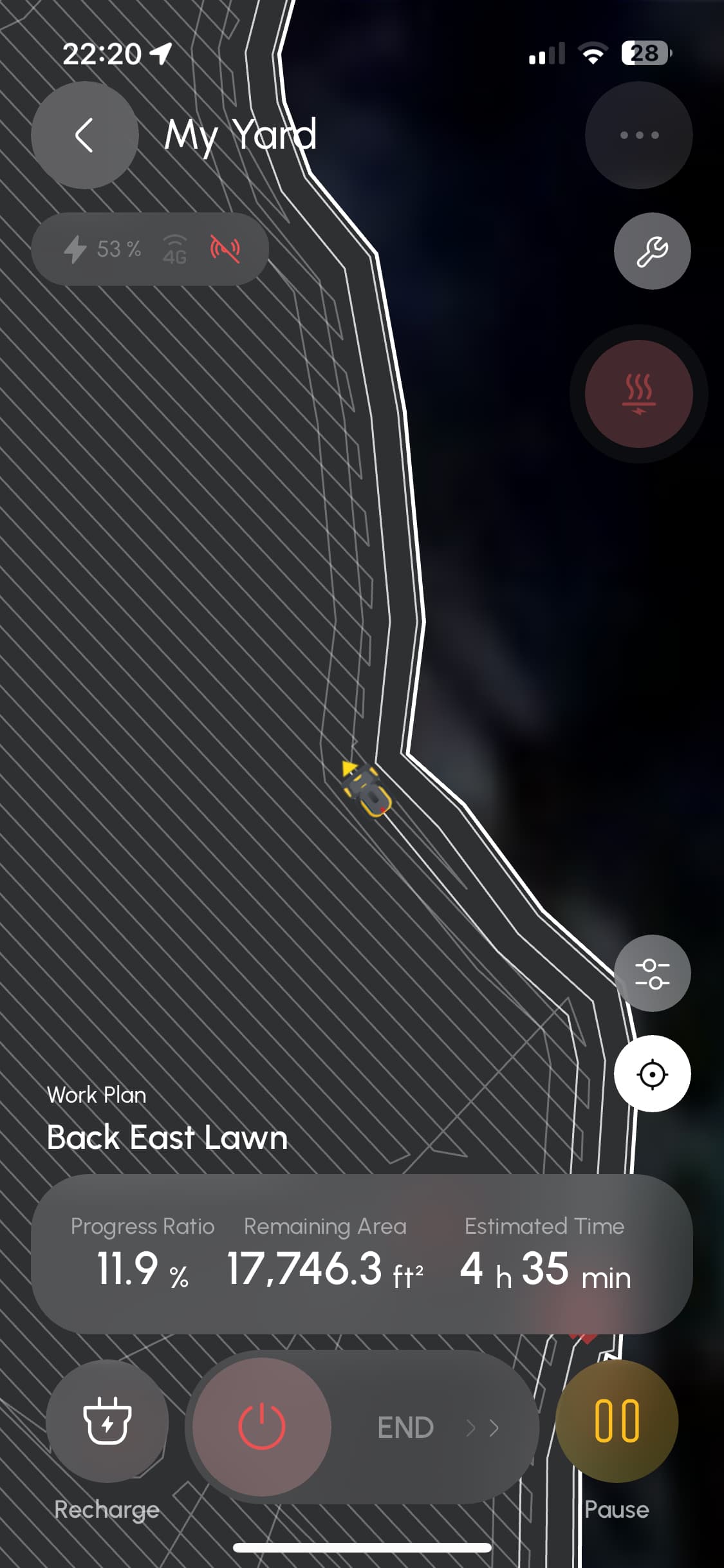

Battery indicator and network connection are grayed out
What does it mean when the battery indicator and network connection are grayed out.
And of course Yarbo just sat there looking lost for a bit while in this condition.
