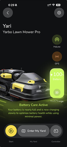

The easiest way to check is on the main screen. It should show HaLow as this depicts how the rover is accessing the Internet. WiFi displayed here should also work.

Awesome! That’s what I needed to know. Was able to sort it out. Halo is operational.
