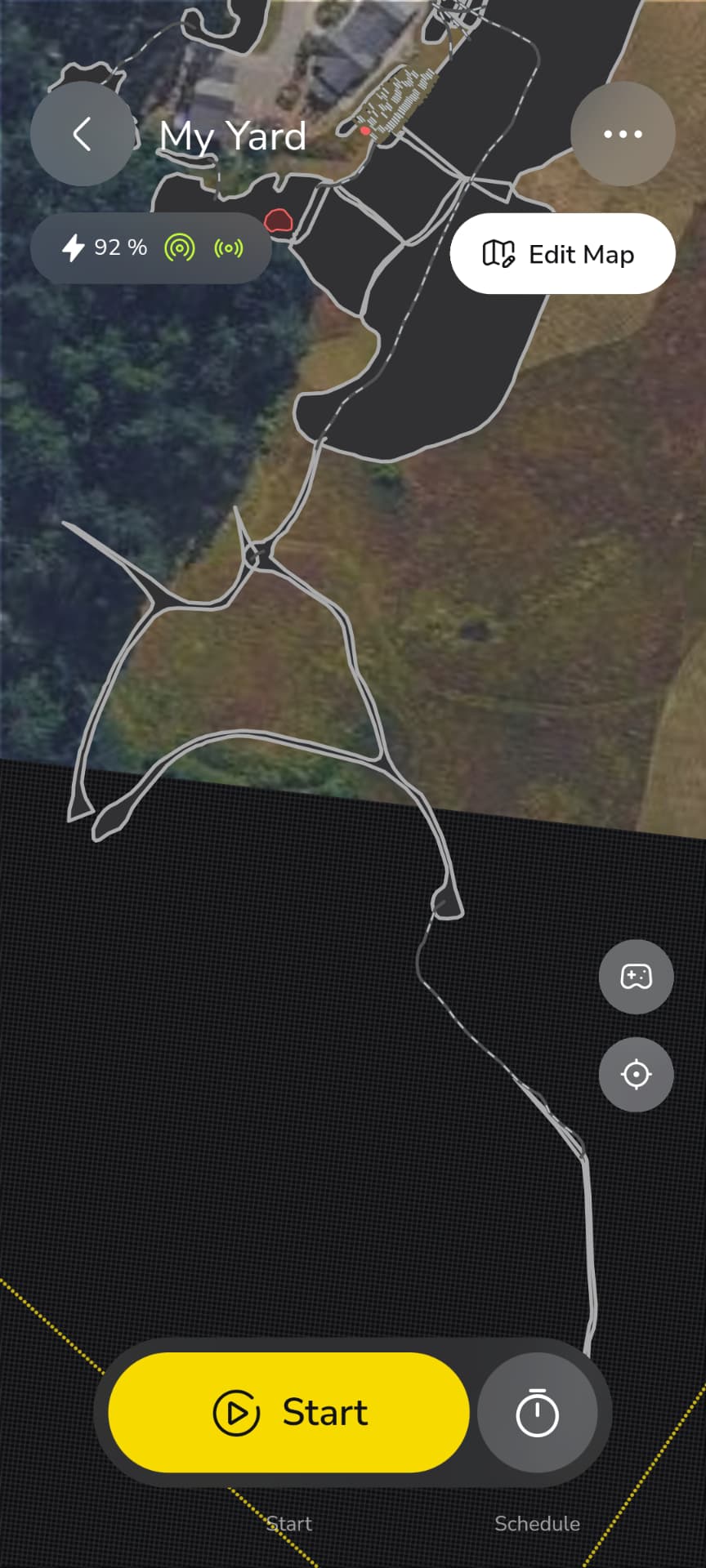

I’m mowing some walking trails through meadowland, and using some ideas here on the Forum, I’ve come up with some good techniches for mapping the trails. In all, there are miles of trails, and it would take a very long time to pilot Yarbo through the mapping routine.
So what I do is disconnect the mower module, and drive the robot into the tractor bucket and drive, putting the gps antenna near the middle of the tractor. Then I just drive the tractor, in Edit Area mode where I want the trail mowed. I add in pathways the same way. At the end of mapping, you just have to accept all the defaults and save. Yarbo thinks it’s a snow blower and wants to set auger speed and so forth. Just accept defaults and edit the plan once you have the mower re-attached.
I would love to take a Google map and a mouse and do the same thing, it would be so much faster. But this does seem to be a fairly easy and fairly fast way to help Yarbo do the mapping.

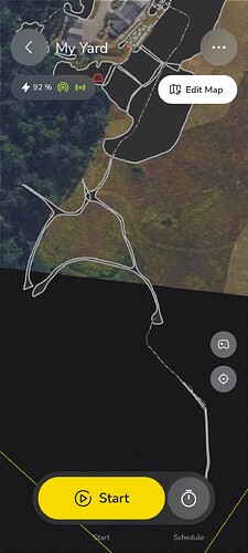

The pasture is pretty open country, but there were a couple of dropouts (past the 50 ft GPS allowance I have setup in Yarbo) that I had to work around. You will see that in the long trail at the bottom, that I’ll just have a pathway to. No big deal, but def a workaround.
Like I said above (edited in rather), Yarbo does think its a snowblower, so you have to edit in your mower preferences after mapping is complete. Hope a future update doesn’t kill the ability to map without an attachment!
