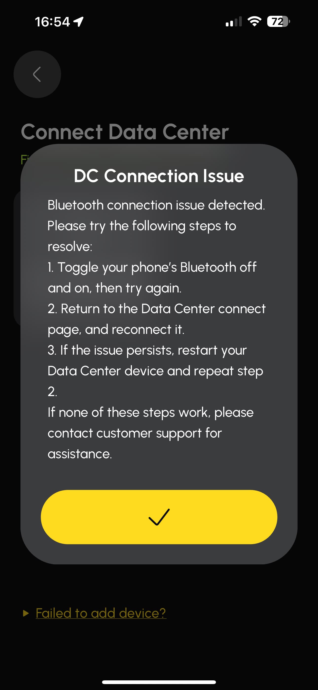

Anybody fixed this error? Started yesterday. Yarbo still works fine but I can’t connect to the DC. I followed the instructions of the error (see image), plus Yarbo reboot, hard reboot, iPhone reboot, multiple times. Again, Yarbo seems to be working fine but unsure of the impact or the being able to connect to the DC from the app?
Have you unplugged the DC for 5 mins and then tried to connect? If that doesn’t fix it, verify that your Bluetooth antenna on the DC is tight and try getting within a few inches of the DC and see if it will connect. If not, get a ticket opened and support can probably remotely fix it for you.

Ok so I climbed on the roof and tightened the antennas (they seemed fine). I was able to connect it very close to the DC b it I am not able anymore from the ground (used to be able from day 1). How far are you able to connect? Anyway, at least for now I can get a connection. Is that loss of range in Bluetooth a symptom of a faulty Bluetooth chip @Yarbo-Forum.
