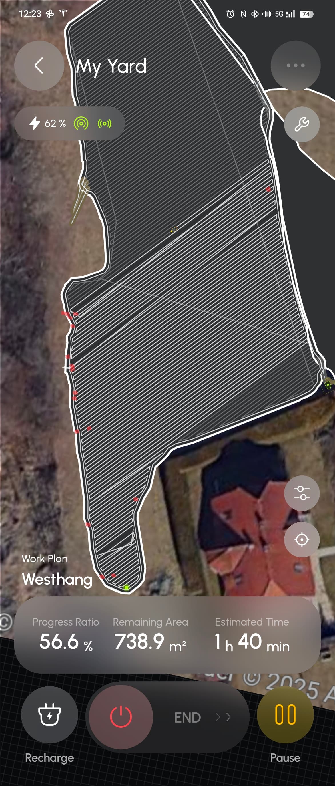

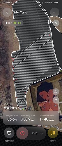

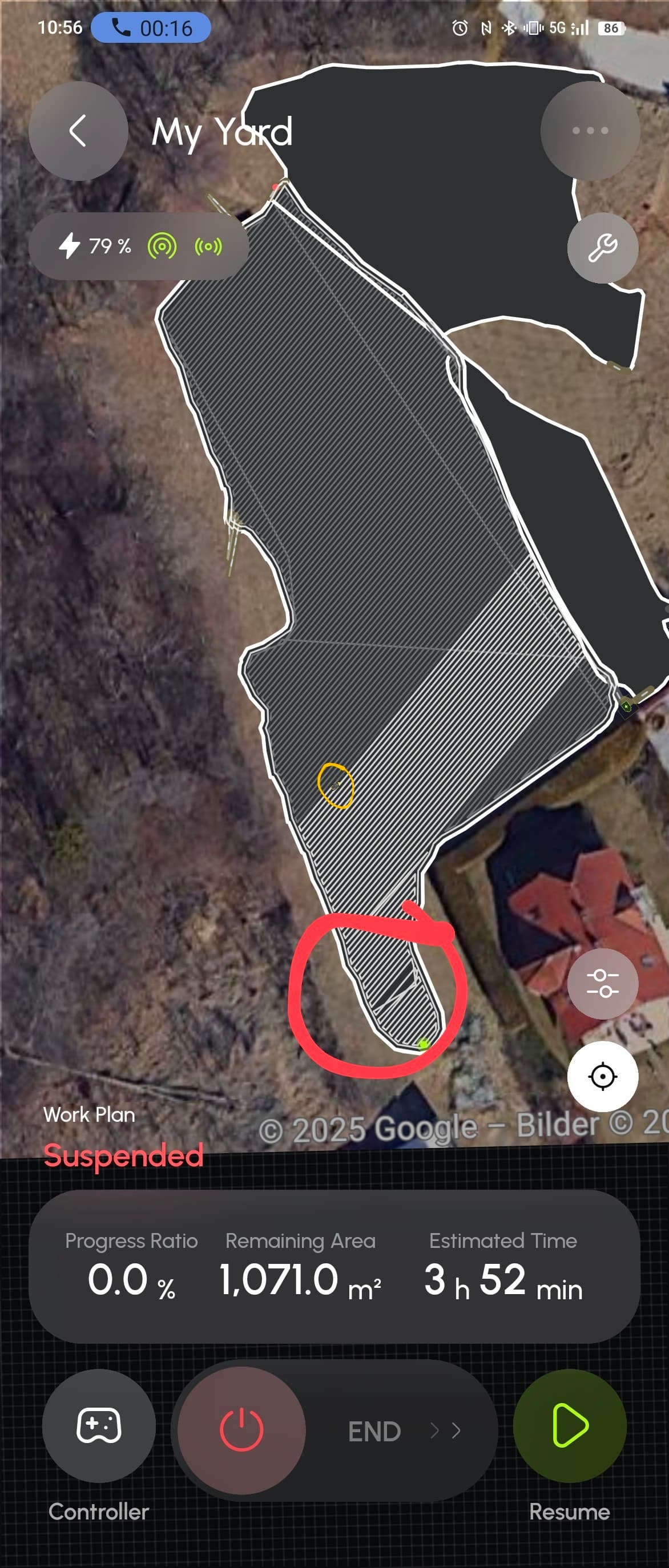

Today I was able to start another area, but before doing that I had to correct map drift. After starting, about 20 minutes into the Job, it was standing in the area telling me it’s out of boundary. Got a notification on the phone this time, pressed resume and it did without a problem.
But it’s now doing strange pathing (red circle}

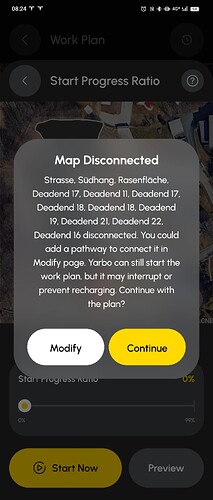

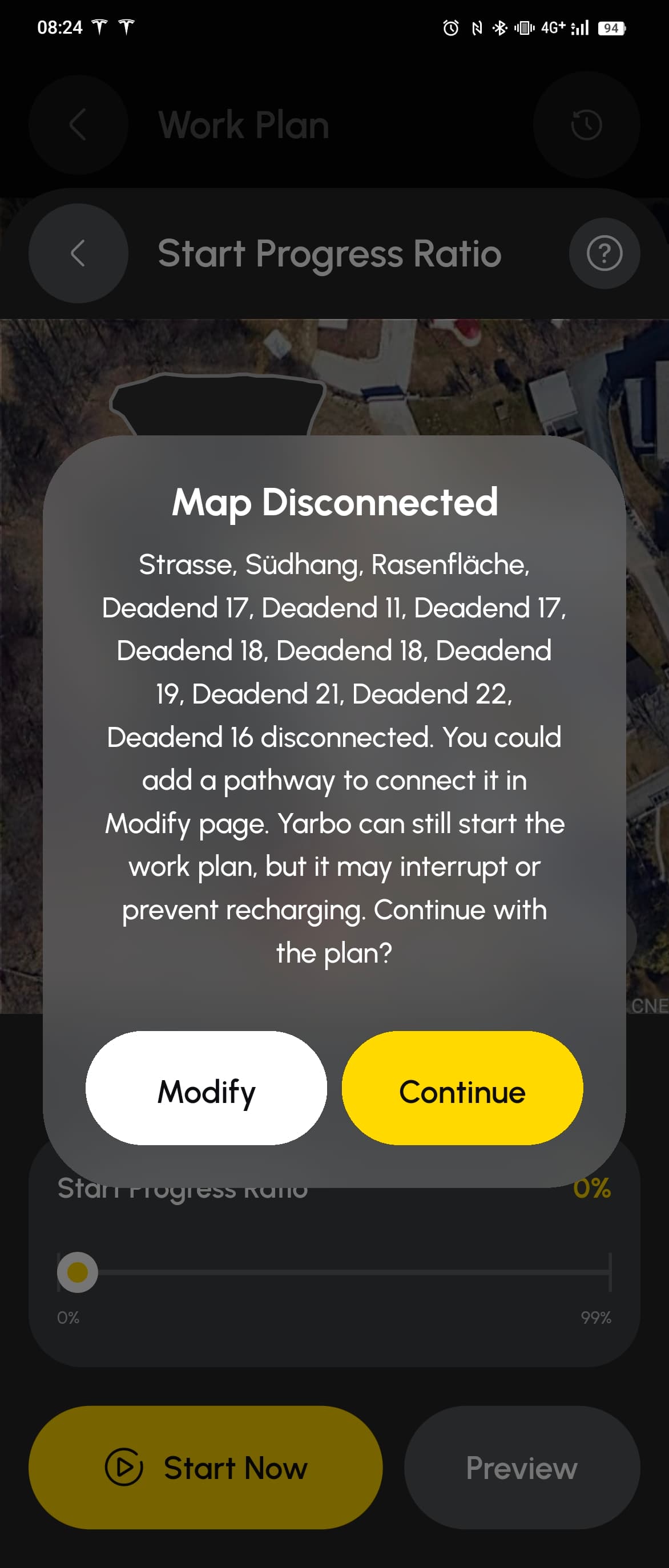

Regarding the problem from yesterday it does not let me start the map at all it tells me it is not connected anymore. WTF.

It looks like your pathway from the dock ends in an overlapping area. I’m surprised this ever worked. Pathways cannot start or end in overlaps. Maybe this might be your problem. General recommendation is to start at least 3 ft into an area and end 3 ft into the next area. If there is an overlap, then 3ft past that.
I don’t know what to tell you, but the connections between areas always worked, so they changed something in the update.
