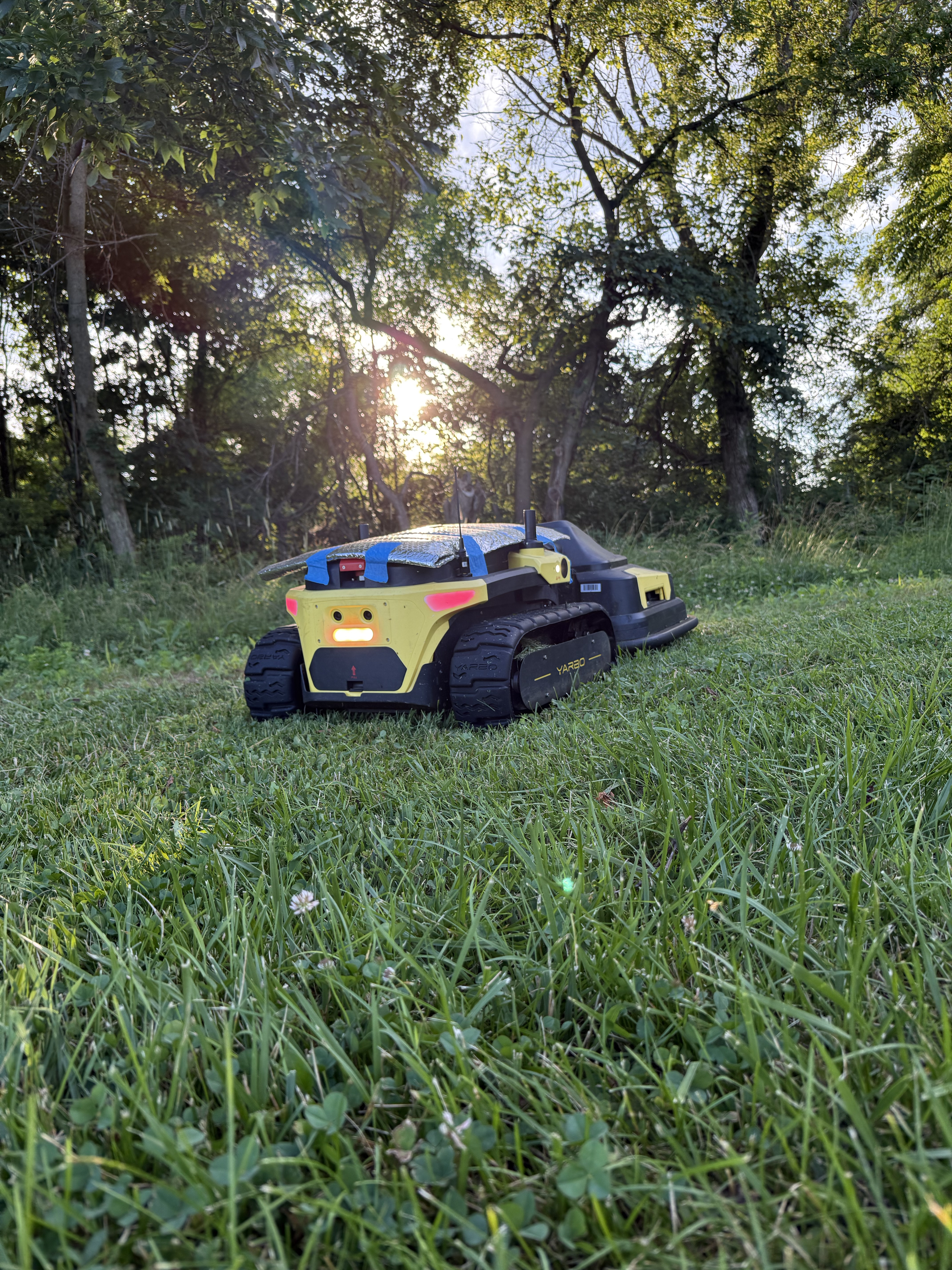

Great… now I have the “Yarbo is adjusting the blade” forever message.
Or maybe Yarbo is just watching the sunset.
Paused the work plan. Exercised the cut height from its 2.7 up to 4 then down to 1.2 and back to 2.7 with the app.
Resumed and Yarbo went back to work.
