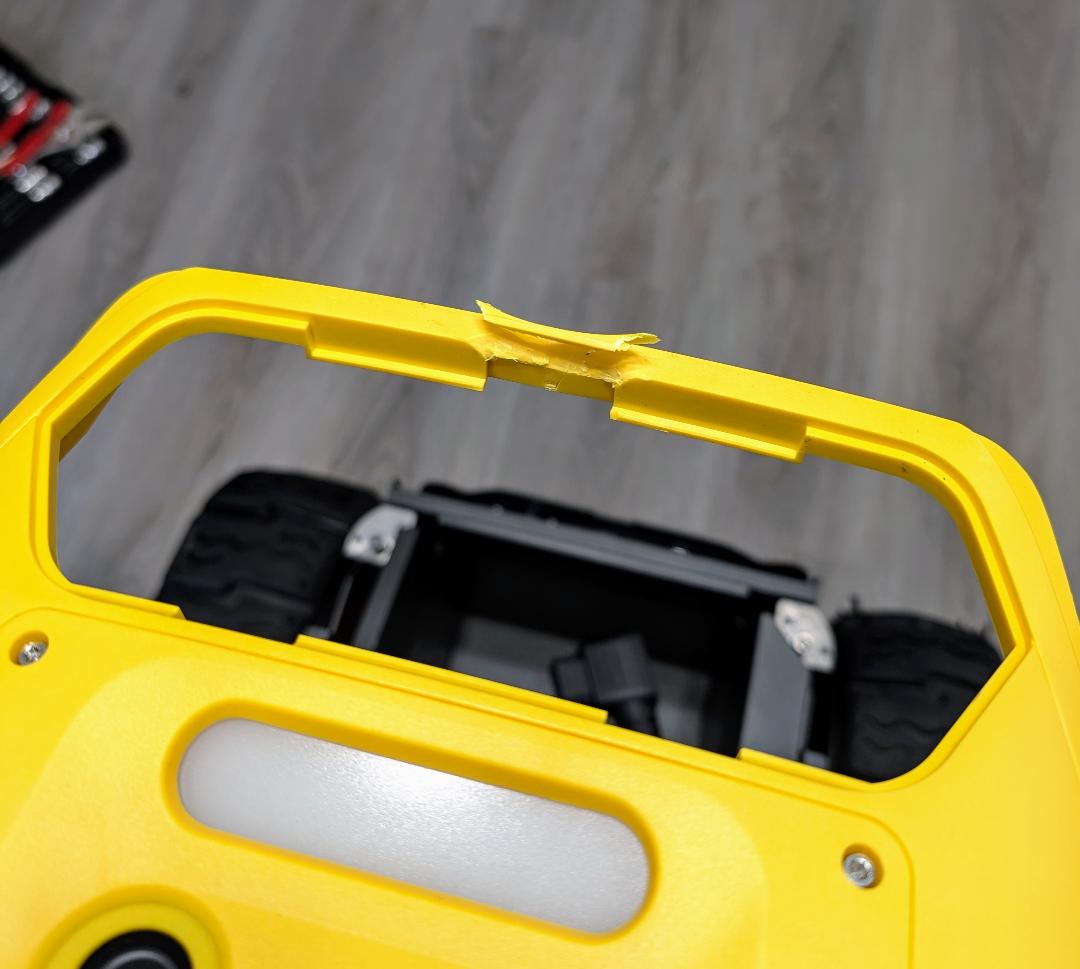

Please show where to hammer a block of wood without busting the covers? Was told to hammer block of wood on frame. Frame is touching the rear cover. It will bust it. Who’s to say, it’s not already busted, if I could get it open?Thanks

Lordy…can you slide something in the center of the rear frame and pull that out and probably down a little so you can at least get the cover open? It may also pull the side back in for you.
I think I’d secure the unit and try to sneak the webbing of a tie-down strap in there below the latch on that cover and use the ratchet (or just pull with muh ripped and massive brute strength) to pull the center of the rear frame piece in the right direction. I think it’ll bend out with a slow pull on some of that tie-down webbing, and it won’t scratch (hopefully).
This one’s worse than the one reported 2-3 months ago where the center rear was just bent up a little and IIRC didn’t take much to pull back down and out a tiny bit.
Thanks, I’ll give that a try. Great link. I just didn’t want to break a new Yarbo. Or void anything. Thanks, if I have any problems, I’ll post, and ask again, or send pics if I have any problems. Thanks again…

Was able to get the frame back in shape. It’s was tougher that I thought, because the frame is very strong. But that’s a great thing. The only issue now is, as I thought. It was pushed in so hard the cover was broken from the pressure of the frame. I don’t know if this will cause the rear cover not to stay closed. Or, maybe they can send me a rear cover not damaged, and I can replace it here at home under warranty. Just glad to have that frame shaped back up. Thanks again.

Thanks just saw the email. “Your replacement will be delivered within 7-10 days.” I appreciate you handling the problem. I have a question? Do I need a new core, or just replace the broken cover piece? You think there maybe other damage? I was able to get the frame back like the video shows, and the rear cover off, as seen in the pictures. I have tools, and can replace the broken cover, if it would be cheaper than shipping another core to and from the warehouse. Whatever you think, I’m ready to get Yarbo up and running. I put the weather sealer that was mailed out on the board last night. Please advise. Thanks again.
