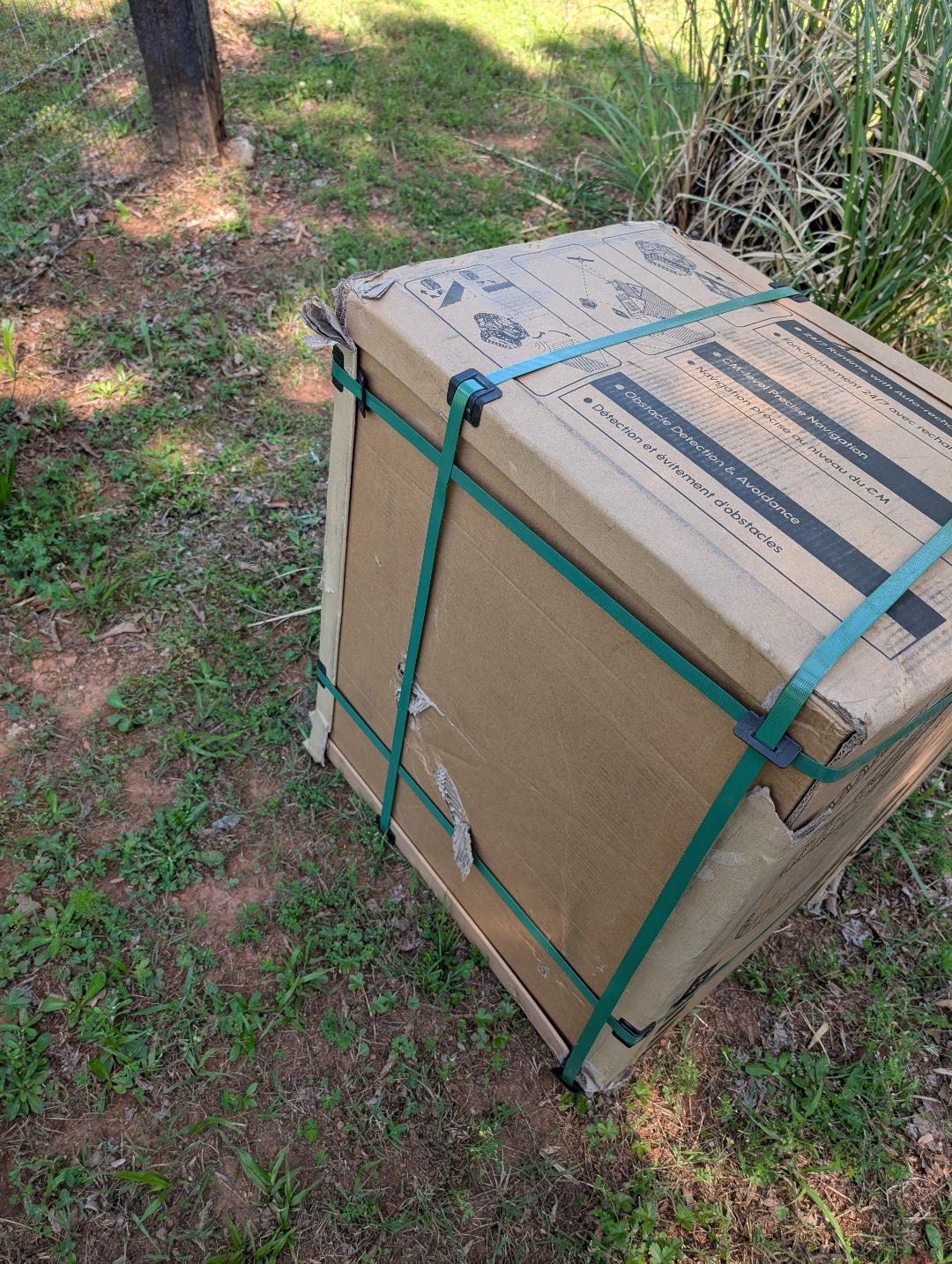

Well the new core showed up today from FedEx. Let’s hope this one is better shape. It really looked like they just tossed it out of the truck. Left it at the bottom of my driveway, outside my fence. No call, for me to open my gate. Just drop, and run. No signing anything.
Box has got some tore up spots. Fingers crossed, that it’s not damaged, and I can get this core back in the box without it coming apart.
Slide the bands off and reuse them. Once you get one or two of those cardboard reinforcements out, they come off pretty easy. Mine was similarly beat up and it was fine.
