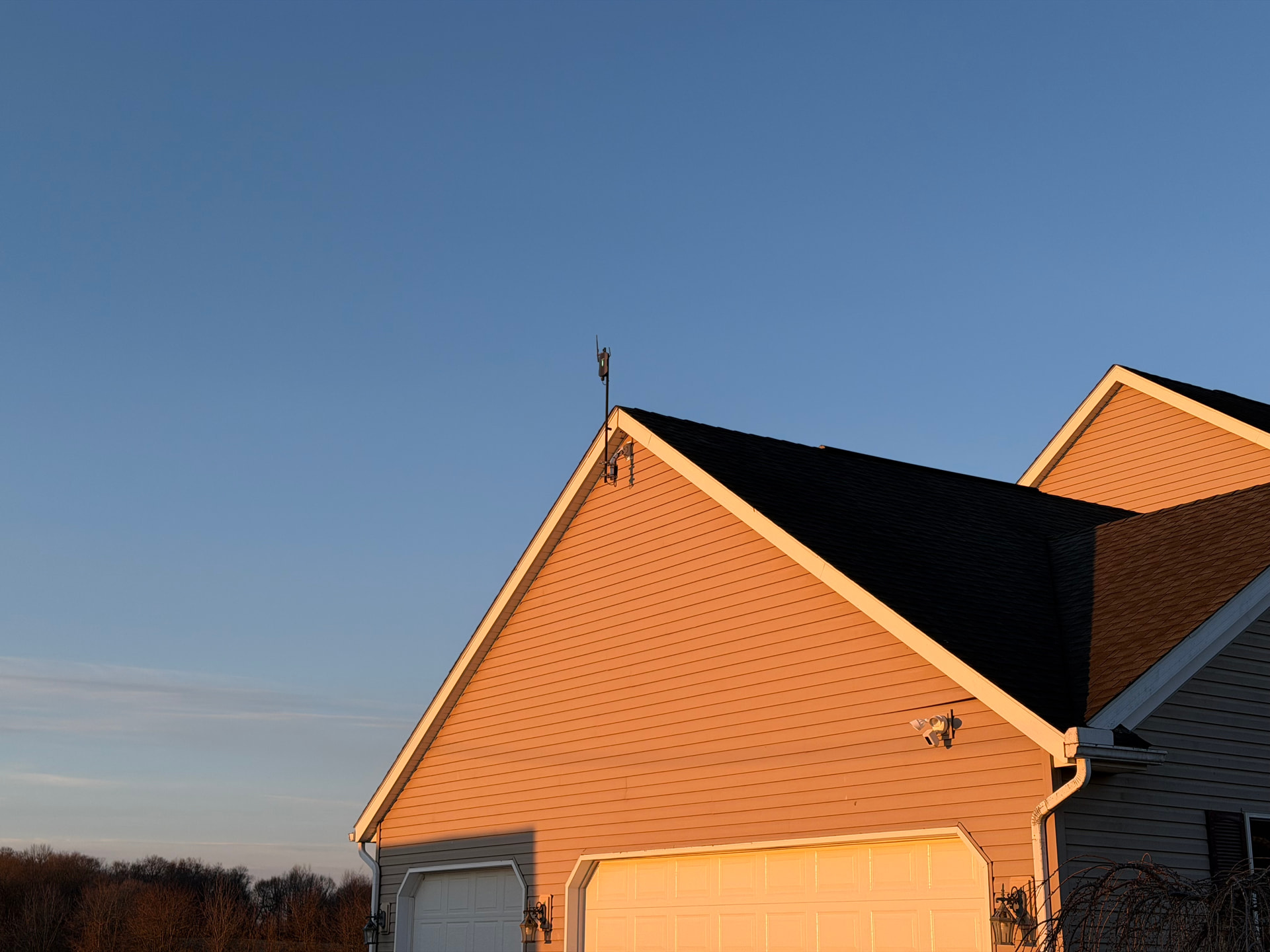

Thanks, Bryan. Here’s the location of the DC, Not sure I could put it in a better location unless I build a mini tower. This is the second core that I’ve had as the first one had GPS issues too and then became a yard brick. They replaced it and this one isn’t much better with reliable GPS.

That looks pretty good, so could be the antenna. If you aren’t having issues otherwise, I’d leave it be.

Talk about textbook DC install!

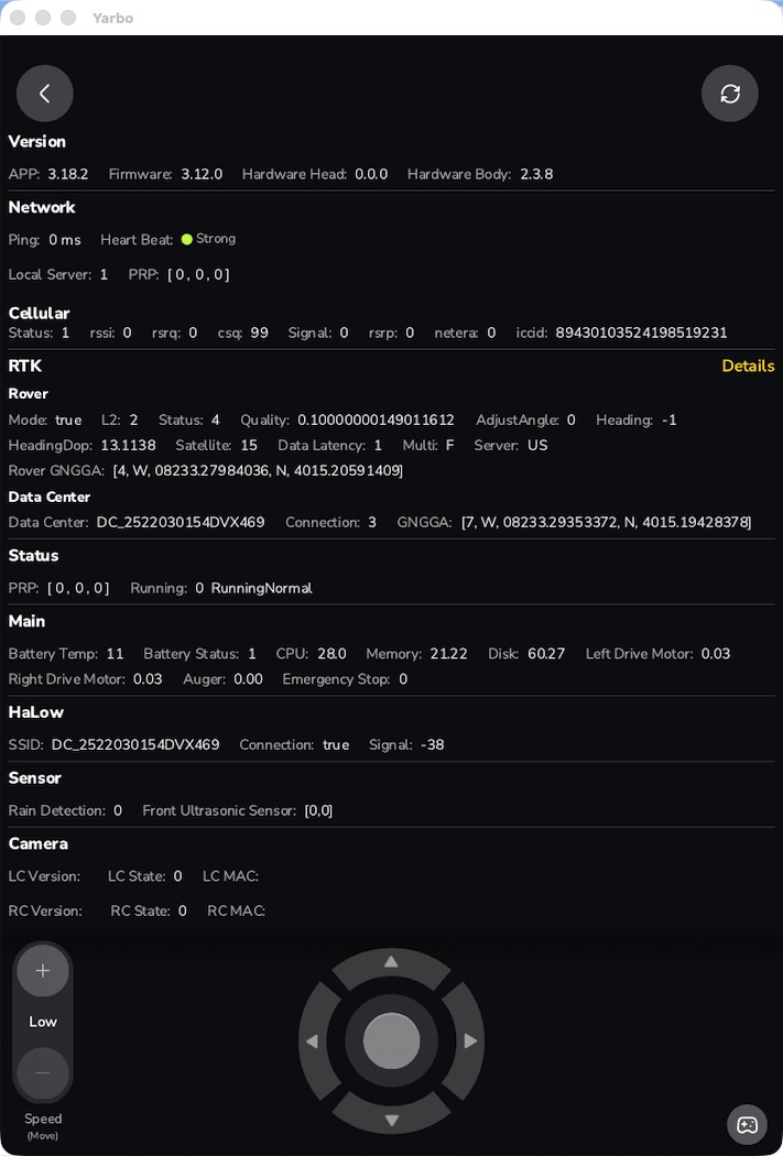

I think the tell is that the core’s satellites are zero and L2 is zero. Assuming that is still the case.
Not the easiest thing to do, but maybe grab the gps antenna off the DC and try it on the core. We know it’s good as the DC’s survey shows sats.

It returns diags from the core based on the screenshots. Reading between the lines its drivable. Power board should be working then. CPU must be working. So power to GPS modules?

Ordinarily I would say based on those numbers that one or both RTK antennas are bad. But there is definitely something else going on (or multiple things).

A couple things stick out. Your L2 and Satellite counts are pretty low.
I’m over near Marengo Ohio and my current satellite counts are L2: 25 and Satellites: 29.

The Halow strength looks good, so at least that radio is working.
