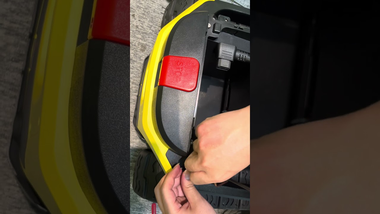

I looked for a video link but I couldn’t find it on discord. Support should be able to provide you with the replacement video link. From what I recall, you have to remove the screws in the battery compartment and use the provided ratchet to remove the bolts on the yellow top of the core. This will let you remove the top shell and get to the cable.
Found this link on the FB Groups. https://drive.google.com/file/d/12UE7TVxQcghEYhac3ttTuWaeaNzNauK7/view?fbclid=IwY2xjawK69nVleHRuA2FlbQIxMABicmlkETFUb1ppaDlhTzJjVnNicEhCAR5pWN-TfdLIBiHV8mDFcGPyFHyvFZxjb32MC40mZ4gk2Y5GmWWGhHYpFo8AIg_aem_0f_9nRRN8FLzIwz_8_JXTg

I’ve done this repair.
It is REALLY EASY the second time.
Pretty easy the first time.
  1. Pop the battery.
  2. Remove the mower module.
  3. Remove those two huge hex screws
  4. In the corners of the battery compartment, there are two smaller hex screws in each corner. Pull them, too.
That’s the hard part. You can use a screw gun to remove them, just ensure you are using the correct bits.
The rest of this is literally about 30 seconds.
  1. Standing in front of the core, lift the shell up, and rotate it toward you (nose down) with the rear cameras facing up. That’ll expose what you are after, and give you the most slack to work with.
  2. Trace the broken jumper to the little board it and the other antenna jumpers screw into. Hard to miss, it’s all the gold hex nuts. Unscrew it, obviously.
  3. The jumper will run through a little clippy thing, and mine had some white goo holding it in place. Free it.
  4. The jumper was also zip-tied to the other cable bundle. Cut that. Carefully.
  5. Fish the bad one out, fish the new one in.
  6. Zip tie it in about the same place
  7. Do whatever with that clippy thing if you care
  8. Idiot-check all of the other gold hexnuts to make sure none of the other antenna jumpers are loose.
On the nose of the shell that is facing down, there are some clicky-type connectors that connect everything on the shell to the guts in the main chassis. Ensure you didn’t unplug any by mistake. All are labeled and easy to put back if you did. If something is wonky after you reassemble, it’ll be one of those.
Ensure (double and triple check) that you do not pinch any wires when you rotate the shell back onto the core. Pay close attention to the rear corners of the battery compartment. There’s a lip that, on mine, one of the wires liked to lay on top of, and I had to tuck underneath.
Be certain to start all of the screws by hand. You have one chance to not strip or crossthread.
And that’s pretty much it. Hardly enough time for @Ken to slam a Pabst.
And a hat-tip of Thank You to the fellows at Yarbo who made this fantastic video for me. It was extremely helpful.
Thanks all! It was really easy to replace.

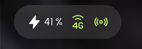

HaLow signal shows in the diagnostics as -67.

Task is out in the “North Lawn” and HaLow currently shows -99.
What’s a good range on the HaLow?
80 or better. Worse than that it starts bouncing to other methods.

I’m currently cutting the North Lawn and there is a grassy knoll between Yarbo and the house. I see its on 4G with a tie fighter… :rofl:
