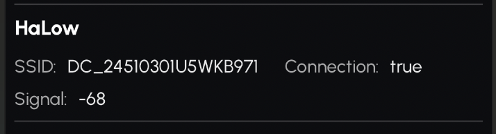

Docked. Charging. Red mark is DC. (Vinyl siding, Tyvek, Chip board, 2x4 studs and about 10 ft of HOT HOT air between dock and DC.
Arrived at charging station:
Antenna removed:
Nut removed antenna on:
There was “vertical movement” with the nut removed and antenna on.
So I put the nut back on.
Back to -69.
There is significant thread exposed with and without the nut.
And there’s the rain. Rest of the North Lawn will have to wait until tomorrow. :wink:
YES! Your signal strength should be much higher than that. You may want to check and make sure all the cables and antennas on both the rover and DC are tight. Anything over -80 and it’s fallen over to cellular.

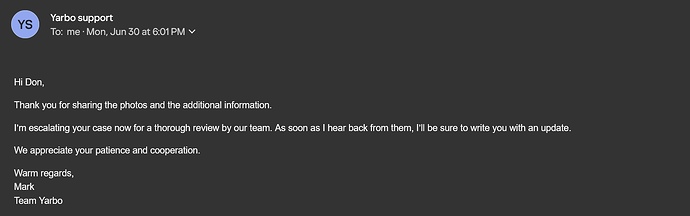

Well my gate got left open to my rtk broke off. Ordered antenna put in ticket to see about getting a new wire. WiFi and cell still pick up.
Same. But trees got mine due to GPS going out. In a NOGO zone. I put the zone because of the bad GPS in that section of the yard. Ticket is what you need. They will need the day, time, and pictures of it. Then wait. Then an email. Then another email.
Hope this helps. Seems it will be a few days, maybe a week or longer???
drop your ticket number here so the forum moderator can check on it for you and order number so they can get it expedited. Like @dandbstephens said, throw pictures, times, details, everything in the ticket up front and it will save time on the back and forth.

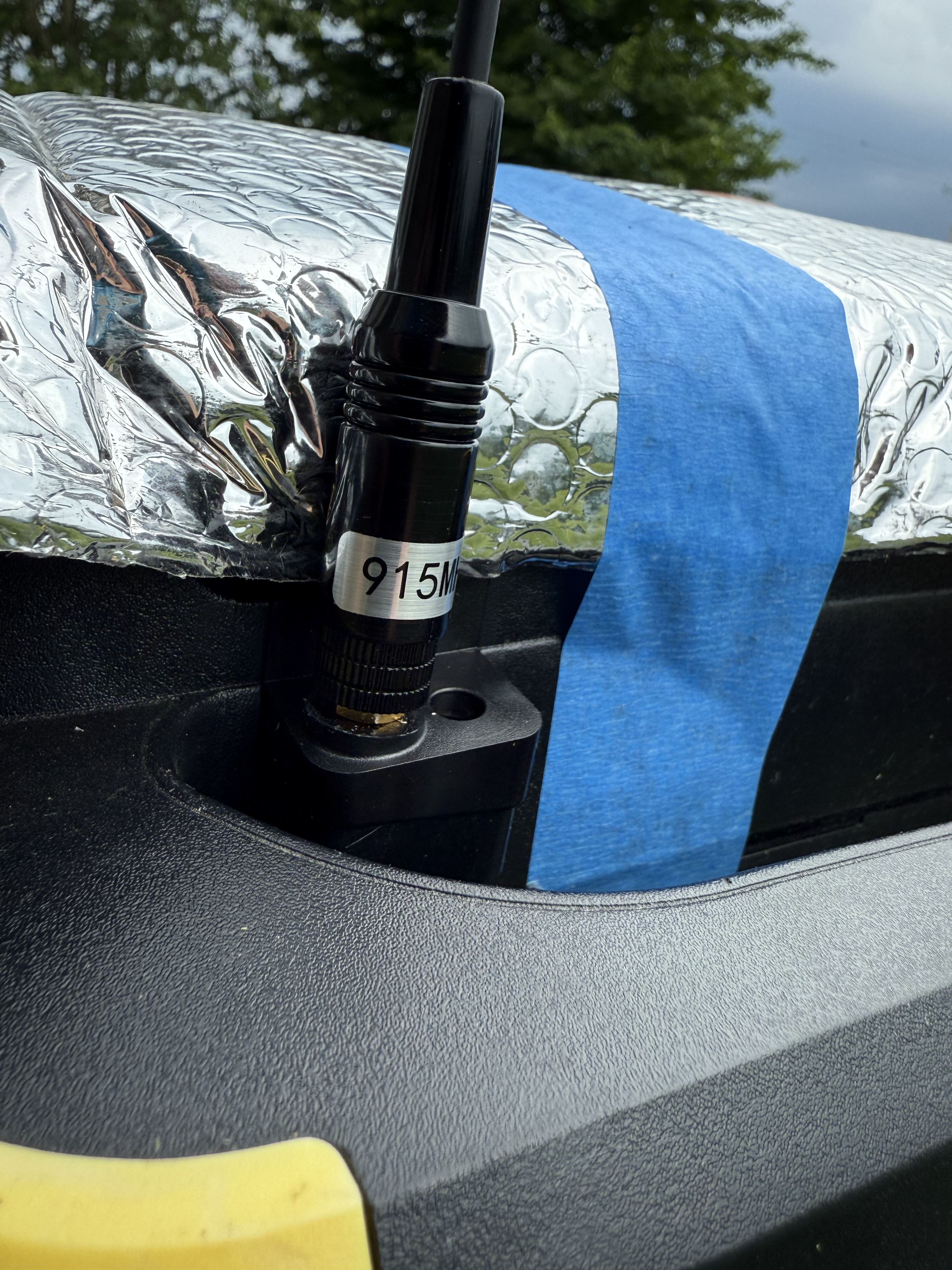

Do anyone knows what’s the frequency of this original antenna?
Ticket Id
#99561
Guess I got to re map and mow that part manually. Just glad it looks like an easy fix.
Just an update on the reply back from support today. Hope it helps others waiting. :wink:
My last antenna came in with a sticker that 915mhz
