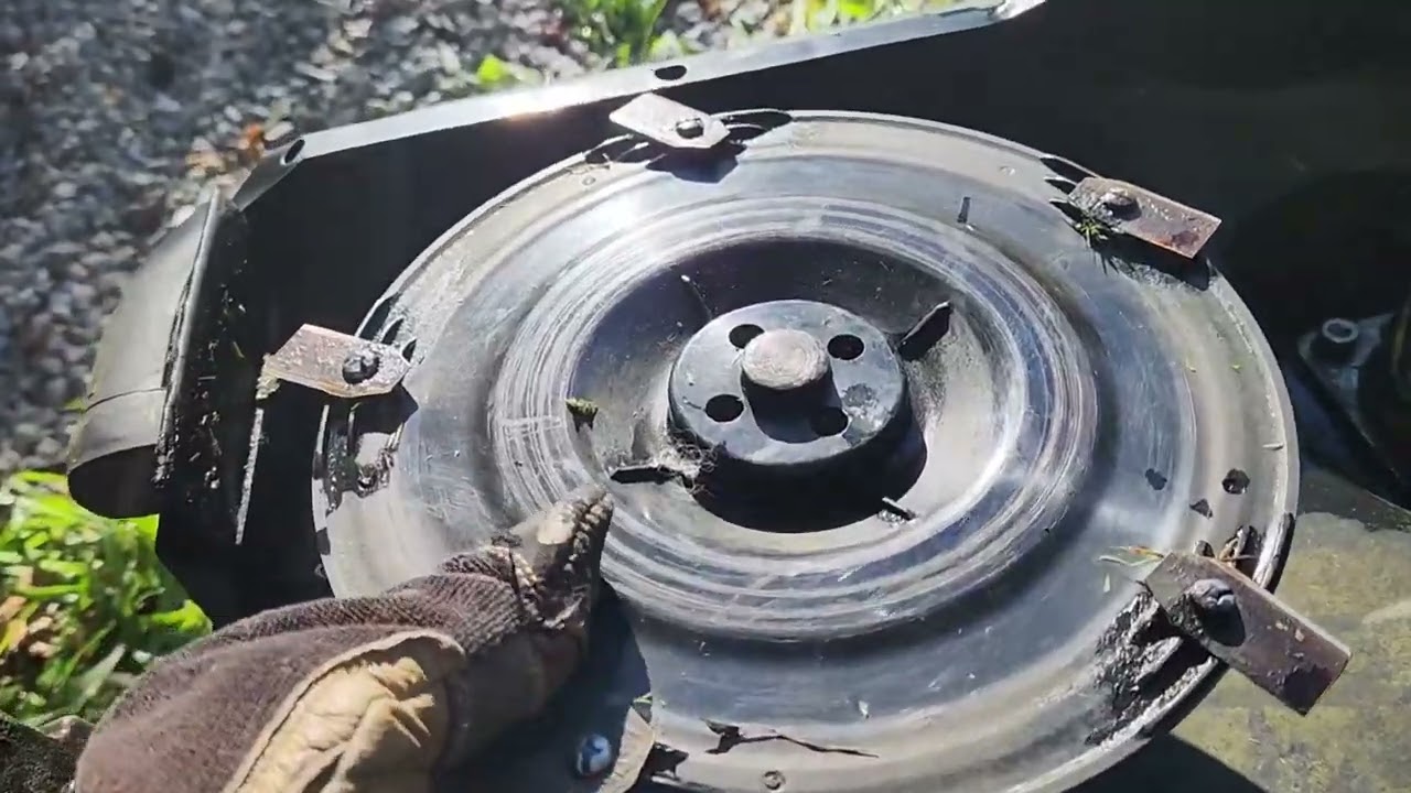

How I do maintenance on the M1, YMMV

after cleaning I always use wd40 on the spindle, blades and just about everything. Is that bad?
No, I’m fairly certain I saw that in their official recommendation to help prevent rust.
