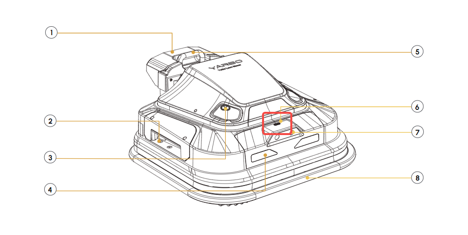

  1. Rain Sensor Maintenance
The rain sensor, located at the front of the mower, detects weather changes. To ensure proper functionality, keep the grooves clean:
  • Cleaning Method: Use a soft brush to clean the grooves marked by the red rectangle. Ensure that no dust or debris is obstructing the sensor.
