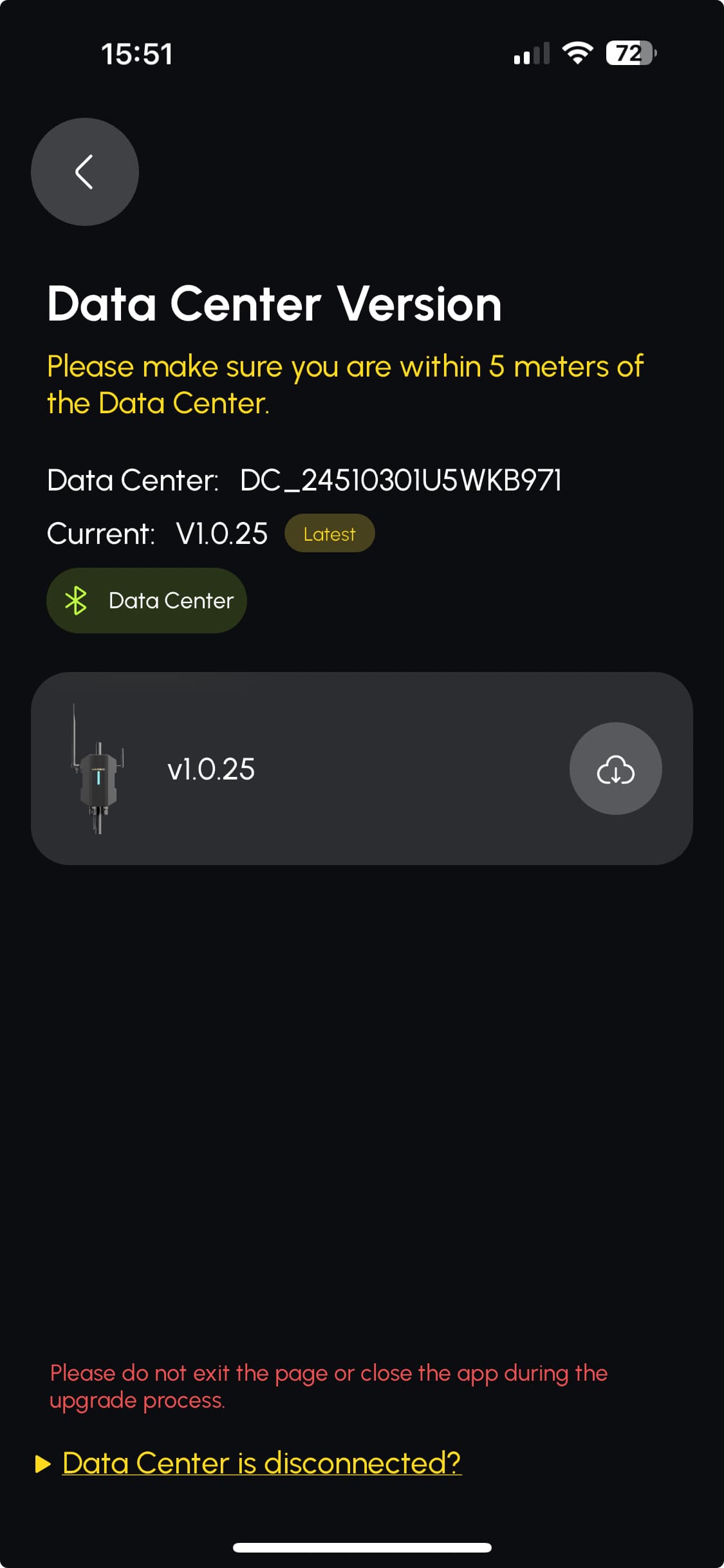

@badstuff9 is the data center version listed above correct? My data center shows version V1.025 and says it’s the latest.
That is a correct version for some DC’s.
