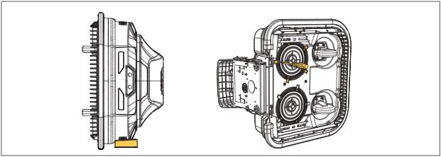

    • Detach the lawn mower from the universal body.
    • Raise the lawn mower from the side and place the lawn mower on Module Vertical Stand, please refer to the picture shown below.
    • Unscrew the Cutting Blades Bolts using Phillips-Head Screwdriver provided in the lawn mower Box content.
    • Install the new blades by tightening the cutting blade bolts.
