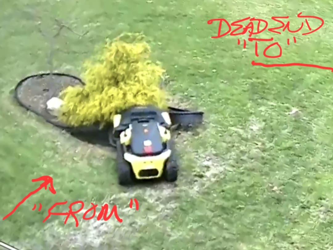

I finished a Work Plan yesterday in that same slightly dodgy GPS area, and the rover seemed to be heading back OK (it was around a corner and I could just see the lights through some brush, I think it was heading to the Pathway), and I gave it a new Work Plan with one Deadend in it. The rover changed its navigation and dove into the woods where it ran off-track before, as if to have calculated a straight line to the Deadend in the Work Plan. That could be “here we go again” with the dodgy GPS threshold, OR it could be the bug where the rover trashes my Peanut No-go Zone when it’s going from mowing one Deadend to another and my Peanut is in the way.
This Picture of Carnage is what it’s done when it has finished the “From” Deadend and is navigating to the “To” Deadend. One time I told it to go to the “To” Deadend while sitting next to the Peanut – the rover turned the mower straight toward the “To” Deadend and trashed the Dr. Seuss plant. Yes, the Peanut is a No-go Zone. The rover sometimes seems really serious about getting to the start of a Deadend regardless of what’s in between.
Anyway, kinda conflating a couple of issues, but there you go.
