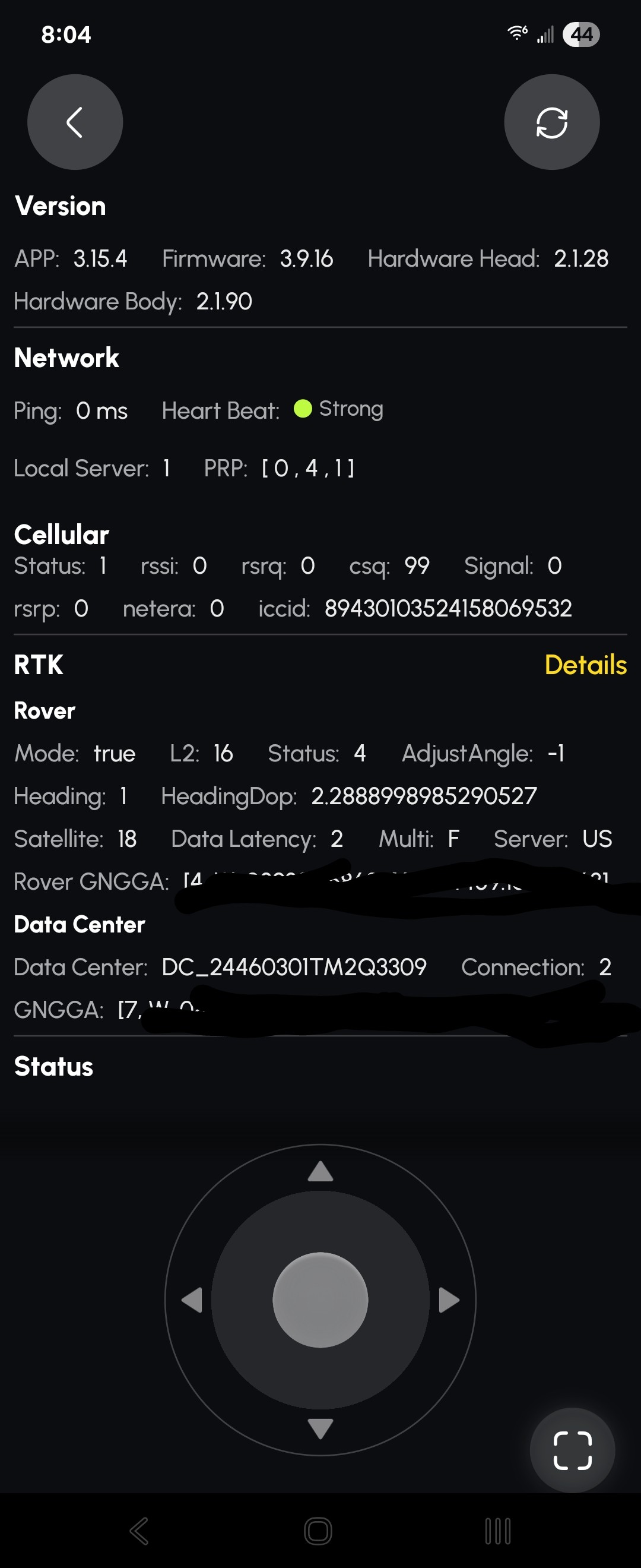

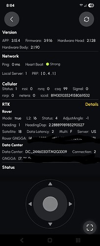

This Yarbo installation use to get gps on it’s dock, now since the new firmware it does not. Anyone see why? Is this a firmware bug?

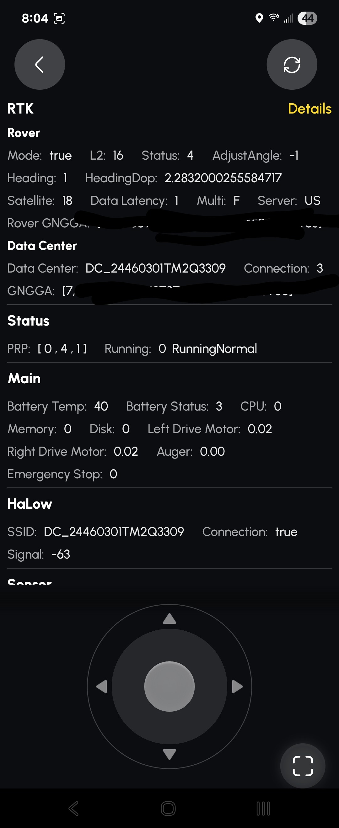

Your Heading DOP is over 2, that’s why. Do you have something new near the dock or something that might be blocking signal? Have you checked your antennas and made sure they are tight?
I’m sorry to hear about the issue. Yes, as Bryan mentioned, the headingdop should be lower than 2. The first step in troubleshooting is to check if the RTK antennas are securely attached to the rover. If you’ve done this and the issue persists, we may need to investigate further. We appreciate your patience and understanding!
It is about 5 feet from a building but it has been there for months now. RTK antenna’s are tight. This just happened in the past week. If I drive it about 5 feet it picks up GPS. From dock there is line of site to DC, building is behind the dock area.
