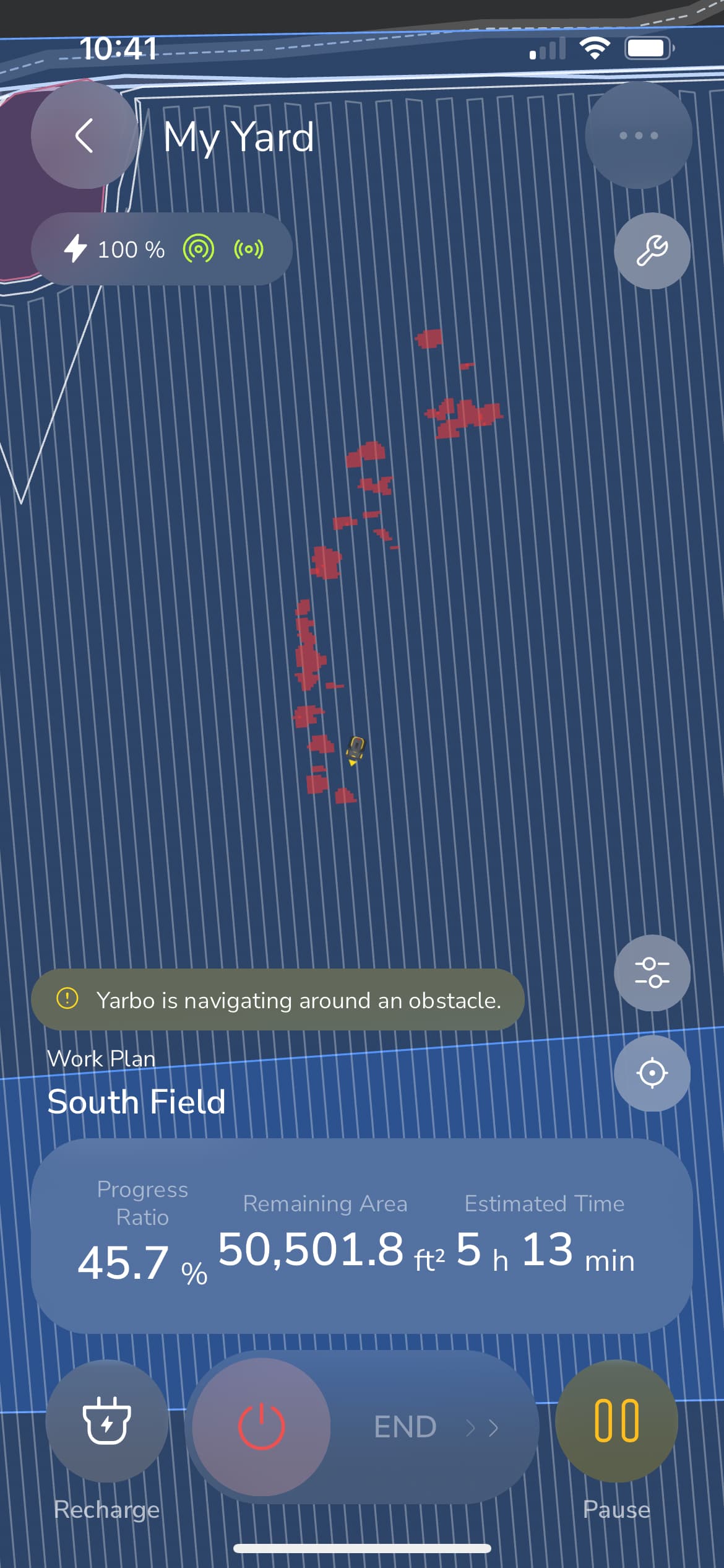

Does the no vision box not work when traveling to the start point? I switch from gentle contact to moderate bypass. Sent it out and now it just see obstacles everywhere it turns. It’s just tall grass.
The blue is the no vision.

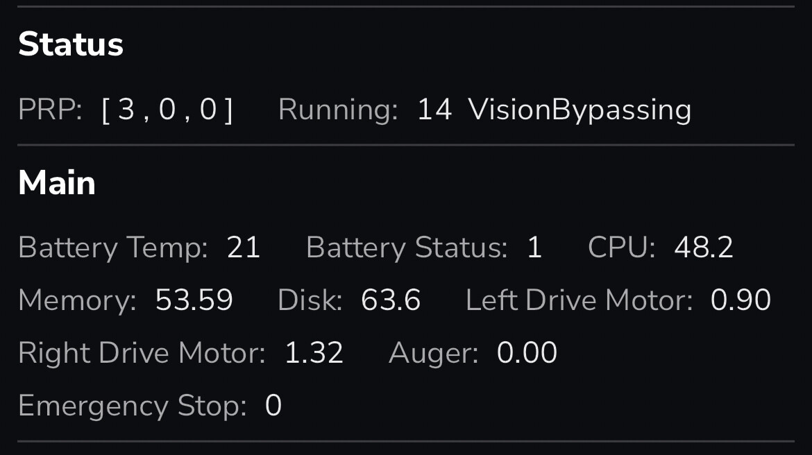

Well even when it got to where it was supposed to start mowing, I manually drove it there. It still is seeing obstacles and it’s showing it’s in vision bypass status.
It’s way worse now than it was just going slow.
The no vision box does not seem to matter. The pro head isn’t supposed to be using the ultrasonic sensors yet? Correct?

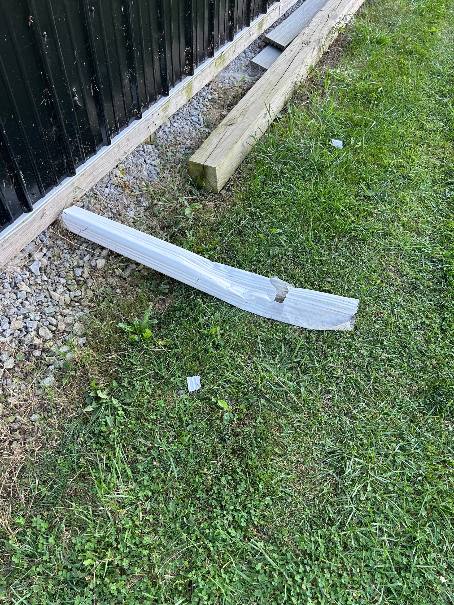

Also something new while it was mowing, (I may make another post) but I noticed my downspout was missing, went looking for it and yarbo ran it over and apparently to hide it’s poor decisions it drug is over 50 feet around two corners to the other end of the barn. Finally found it all torn up.

always trying to hide the evidence. :wink:
