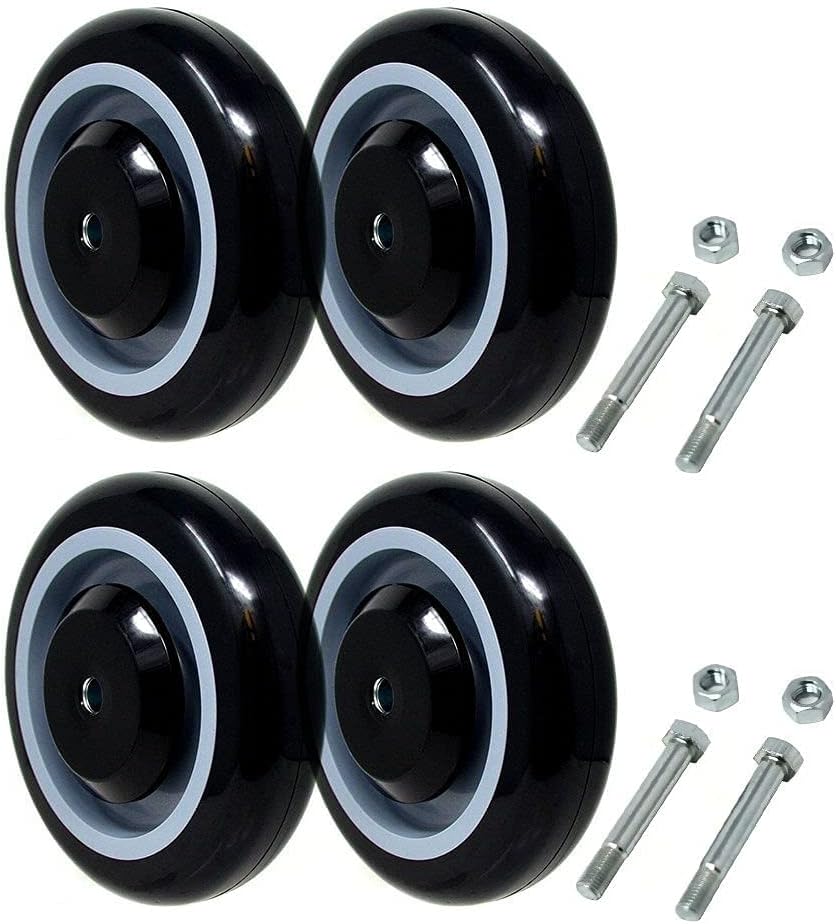

I had to remove the castors, then pop off the wheel covers to clean out the grass. I ended up replacing them with a different caster that had smaller covers so they could be blown out.
Good to know. Thanks for this, I may look at getting some on hand just in case. Any particular one that worked well?
I am able to keep them rolling, but a little more friction than I would expect.
These are the ones I bought, recommended by another user on a Yarbo FB site. I can’t find the other post right now:

These lasted a few weeks before the bearings fell out, still turn. Lost my swivel though
