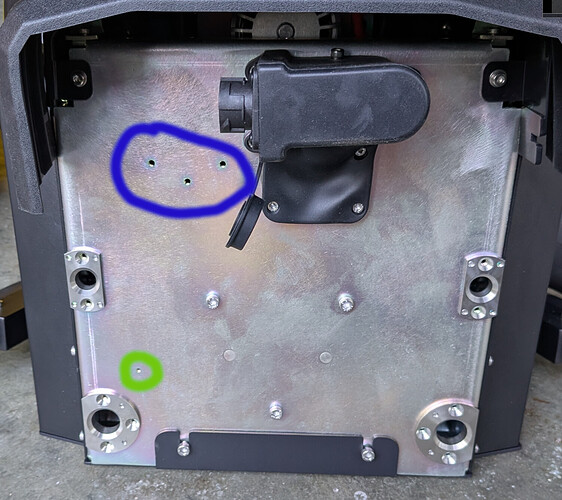

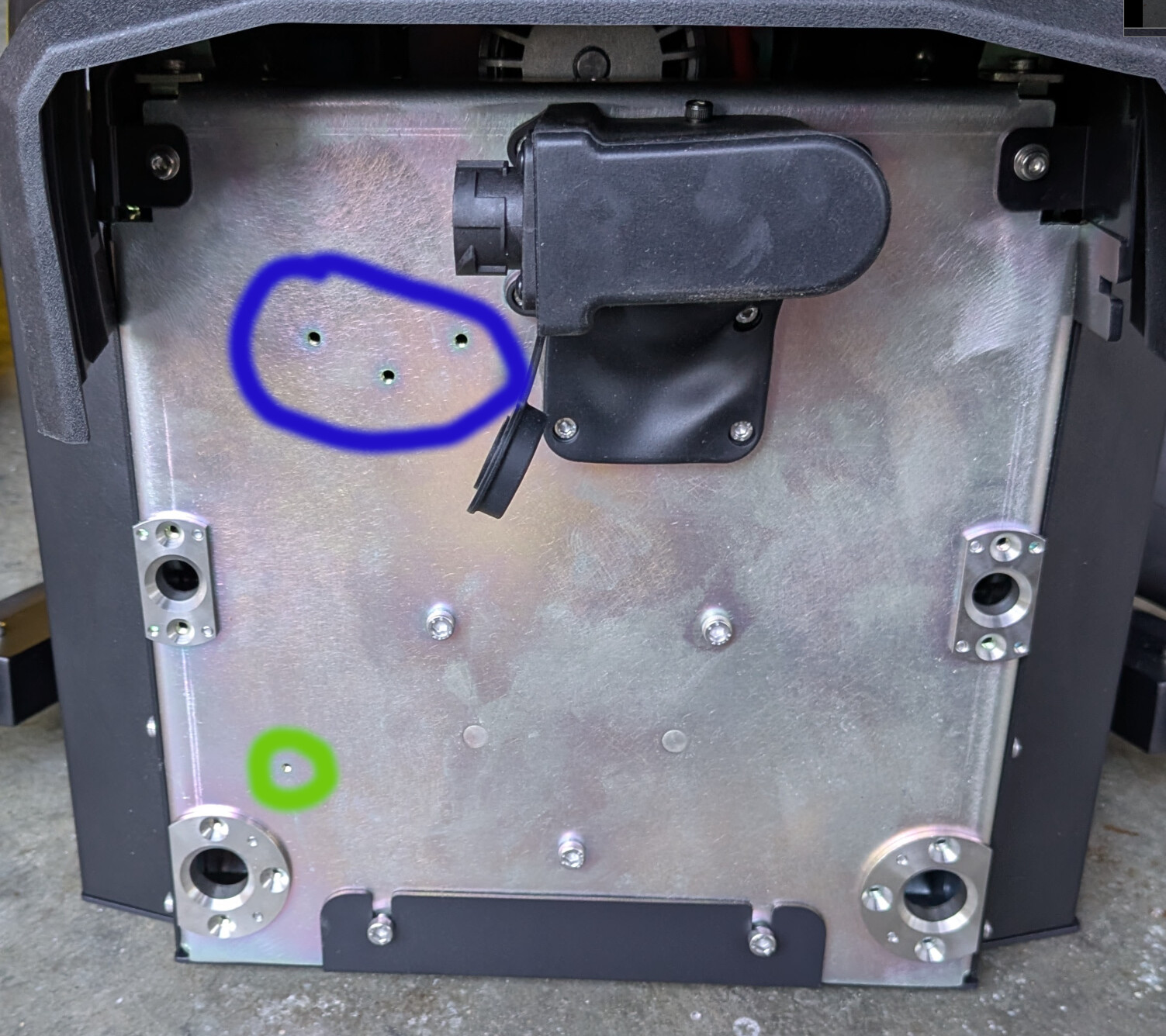

When I first hooked up the leaf blower module, I got an error message for “Module Loosened”. I spent way too long reattaching, rebooting, etc before I actually looked at the components to determine what sensor might be triggering that. I noticed the contact sensor on the core, which led to me looking at my other modules and deciding that I am missing a magnet where the green circle is.
I attached a small magnet with some painters tape and the error went away. I was able to use the blower, but it seemed to stop blowing quite often. That made me wonder if I might be missing another part where the screw holes in the blue circle are. Anyone have a photo of the face of a working unit handy?

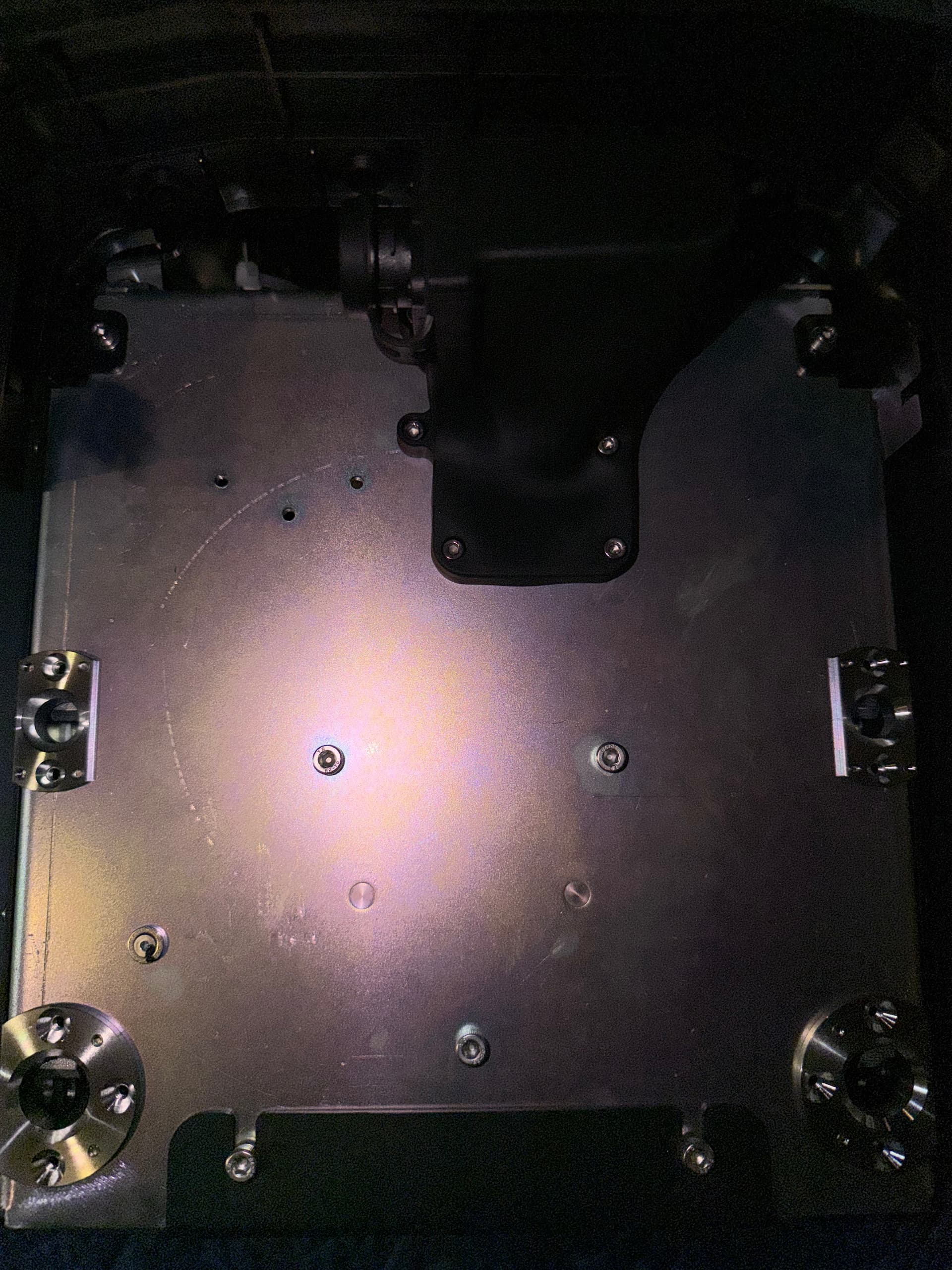

Looks like it’s normal. Here’s mine.
Great. Thanks Bryan!
