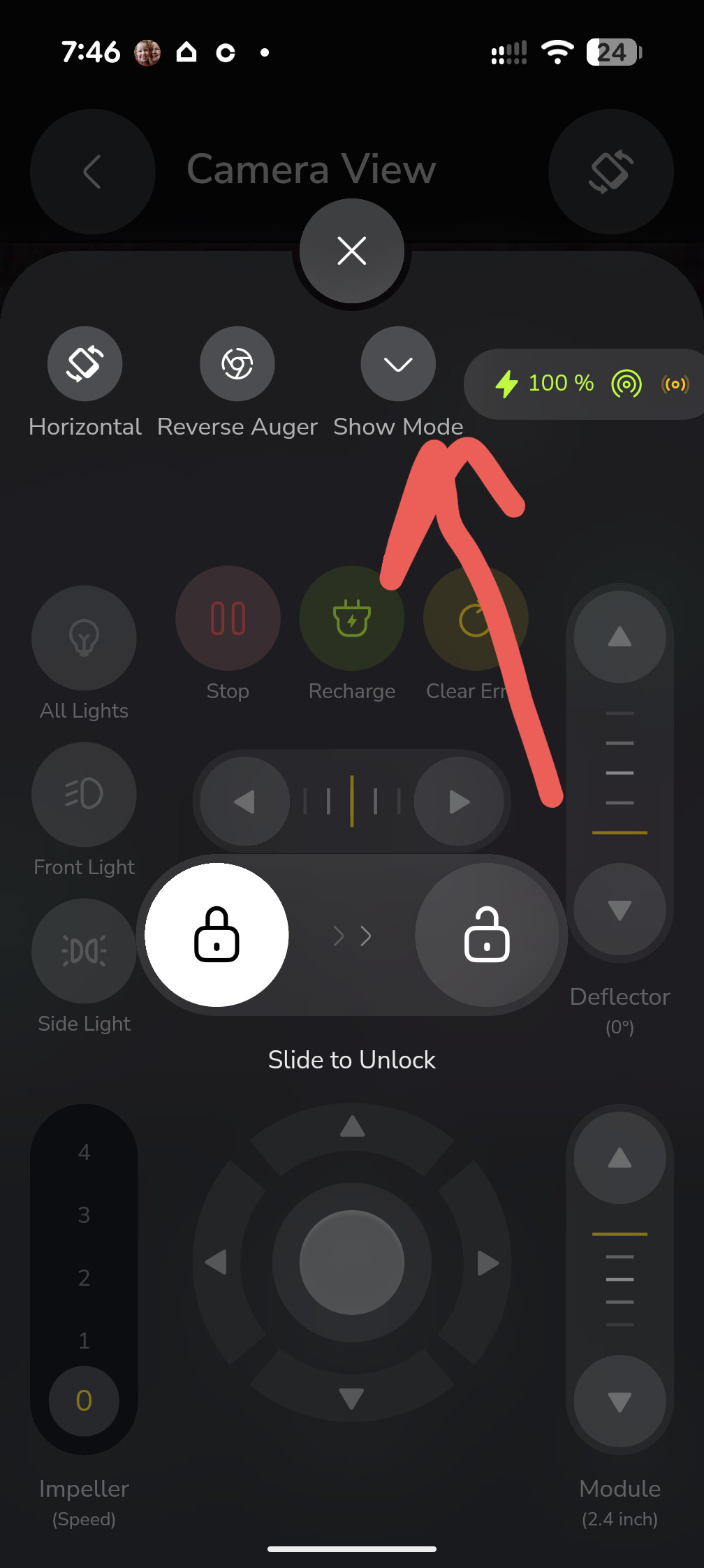

1.2/2 is sorta doable currently,if you open the controller screen with the bottom right icon in smart vision and then click show mode button you get a dim view of the camera…would be nice if the dimming went away😅
You can turn the lights on from the app. If the machine is charging, tap the blade or auger button to stop charging and then turn on the lights.
In case you didn’t already know this.
I didn’t want to bother stopping charge and restarting😁
It is a lot of taps and nested menus to deal with.

Ya, I was already aware of the “show mode" button and have used it in SmartVision and map views before when ole HAL9000 has gotten stuck in loops trying to navigate around obstacles, but it is very cumbersome to use and not at all efficient.

Any plans to allow snowblower with smart vision? Right now minimizing the controller screen to go back to the cameras stops the augur. It needs at least basic controls to do some work
Try horizontal view. You can also use another device to do the remote while using one for smart vision
