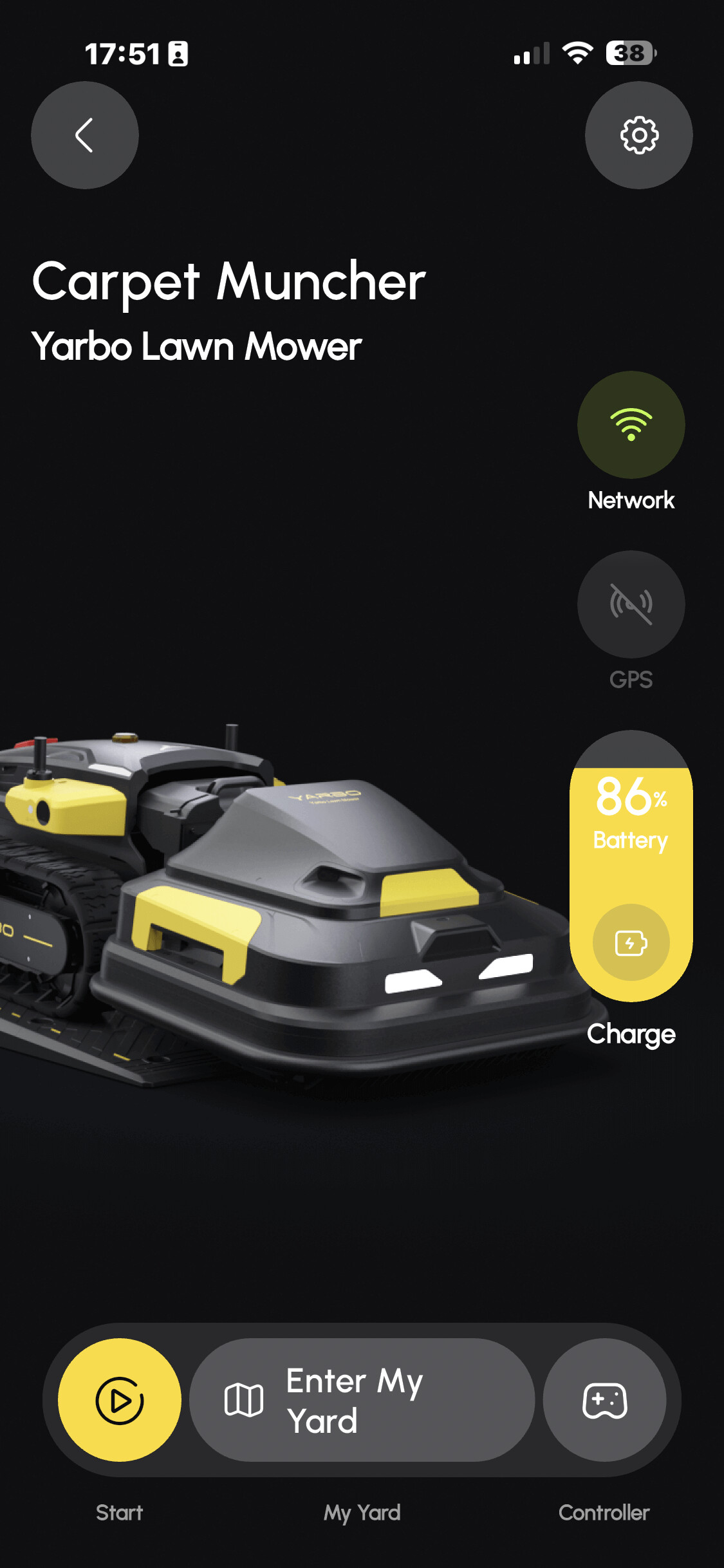

Losing gps but have 27 satellites in diagnostics
why doesn’t it drop like this. I pulled the battery and it came back for a while and it is off again. Pulled the battery like before but isn’t coming back.
You do not have connection with the data center. Another issue is that your SIM is not on. I don’t see the Halow status.
Is the data center green? Is it connected to the internet? Try a disconnect and reconnect of the data center if is already green. When did you activate it? (I don’t see the firmware version but is the data center currently updating?)
There are a lot of “not connected” things on the few I can see. But I don’t think this time GPS is the problem.
Definitely an issue with the data center connection. Is your HaLow status true or false? Pull power to the data center and the battery cable on the rover for 5 mins. Power up the DC and then the rover. If it disconnects again, I’d open a ticket.
You can try the solution suggested by our community member to see if it helps. If the issue still persists, we recommend submitting a support ticket with a detailed description of the problem, along with the steps you’ve already taken. This will help our support team better understand your situation and assist you more efficiently. We truly appreciate your patience and understanding!
Rebooting the data center fixed it.
