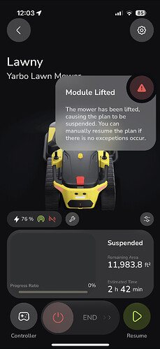

Module lifted errors since the update
Has anyone else been getting constant “module lifted” errors. It is happing so frequently the Yarbo is unusable.
They changed the default to enabled in this firmware. It’s a little sensitive. You can disable that and rollover detection in the working preferences.
