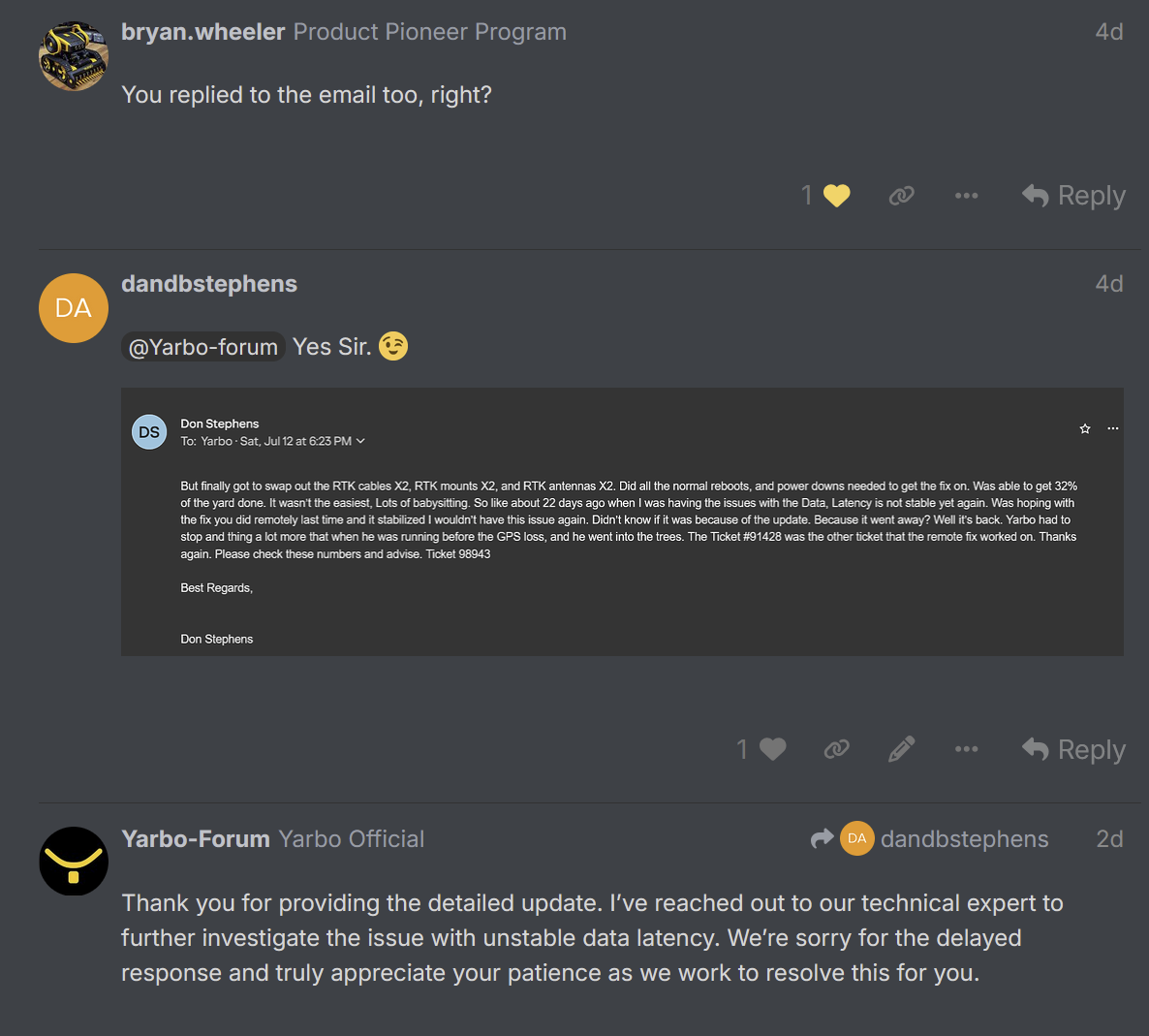

Thank you for providing the detailed update. I’ve reached out to our technical expert to further investigate the issue with unstable data latency. We’re sorry for the delayed response and truly appreciate your patience as we work to resolve this for you.

@yarbo-forum Well 4 days have come and gone. Nothing has changed. No fixes, grass keeps growing, as it has all summer. Can we please just get these multiple GPS issues fixed. Lots, and Lots of folks on here have had so many issues before the update with multiple things. It really seems like we have doubled that. Can we check please check to see what’s taking so long to get my latency stabilized. It was an overnight remote fix before. Have we added so much to the new update, that we can’t find whatever fix we made last time? Please and Thank you…:wink:
I’m really sorry to hear about the continued inconvenience. I’ve passed your case again to the technical expert handling your support to check whether the same remote fix used previously could be applied this time as well. That said, I’m not yet certain if the current issue shares the same root cause.
Also, have you had a chance to schedule a meeting? If there’s a time that works for you, I believe a live session could be the most efficient way to identify and resolve the problem.
We truly appreciate your patience and understanding as we continue working to get this sorted out for you.
