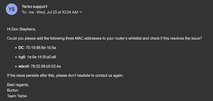

But I did get this this morning. but this has been checked too. A month ago I’m thinking. :expressionless_face:
Check the filter settings:
I’ve checked IP Filter to view blocked IP addresses. None are listed.
I’ve checked Domain Filter None are listed.
I’ve checked MAC Filter None are listed.
So none are blacklisted as they Support thought might be the problem last time. We checked, and again. All are in my router, I have them labeled for quick reference.
