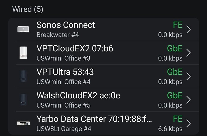

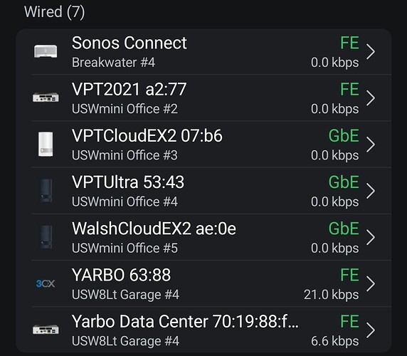

Dozens of them until i pull the plug on the DC. Has happened 3 times recently all in the same zone (opposite side of house from Data Center)
Yep. Seen something similar. IP Pool exhausted and WAN fails. A reboot of DC restores everything. Something is going very wrong in DC code.
Ticket #108517 submitted on the issue.
Looks like a job in the DC is spinning up a virtual NIC, then crashing. Process restarts, spins up another. Wash, rinse, repeat until hilarity ensues.

Somebody did. He’s got two leases out, one of which has activity.
I only mention it because I have exactly the DC and nothing else.
Those are all wired leases fwiw all reporting on the data center port. Those screenshots from when haywire.

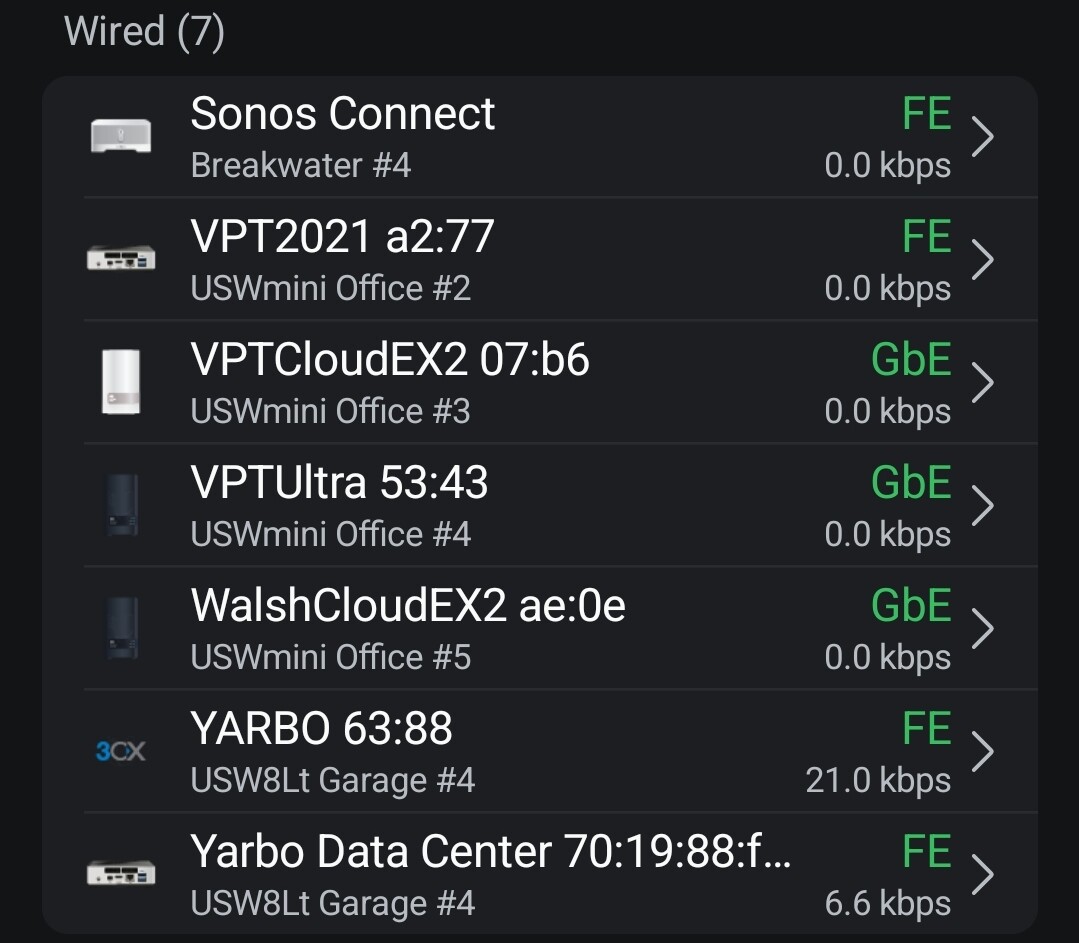

This screen shot is current. Just after I unplugged the physical charger from the unit.
I am about to power down the core and unplug the battery and see what’s still showing.

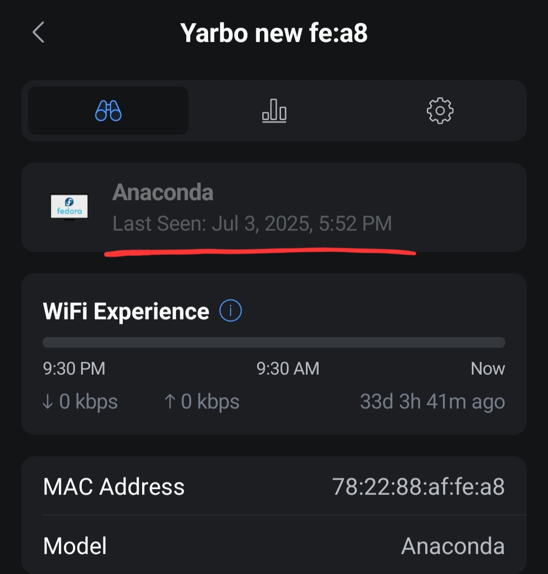

OK I saw no change when I powered down the core and waited a few minutes. However after I unplugged the battery from the core the other lease disappeared.

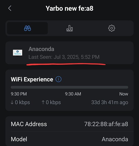

Here is the detail of the mystery lease below.
Plugged the battery in and did not press power on the core. It never(20+ minutes) showed up until after I pressed the power button on the core. Then the other Yarbo Mac was back a minute or so later.
I confirmed core wifi Mac hasn’t been seen since I told it to forgot the credentials at the beginning of July.
