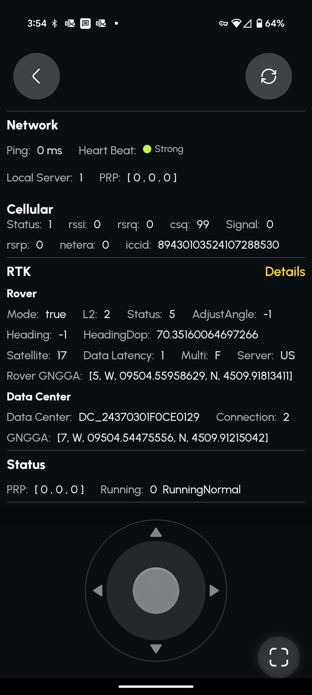

After replacing the latest round of broken antennas + cables, I am no longer able to get a green GPS light on the app. I swapped antennas replaced cables, etc and no luck.
Does anyone know an advanced diagnostic method for the RTK system?

Your L2 antenna is the problem (the right one when facing the robot).
  1. make sure the antenna is working (take the right one when facing the device, install it on the left and check if your satellites show up the same). If yes, this antenna is working. If not, you still have a faulty antenna.
  2. Check again the connections.
If you can’t get any better L2 signal, open a ticket? Faulty RTK controller?
Agree with @Micke and that’s right as you face the rear of the device. If you replaced cables, make sure they are snug and didn’t get pinched or cut when you put the top back on. If after swapping left to right and right to left the L2 numbers don’t show and there’s no cable issues then it could be something in software or hardware on the core.
