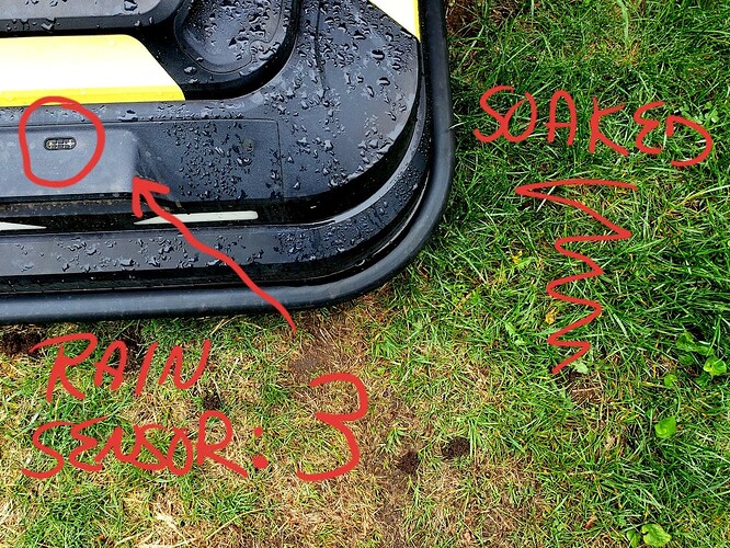

This was earlier today. The mower’s wet after overnight rain, the grass is soaked. The sensor? 3.
It really needs a grass moisture sensor, which I threw in a suggestion for.

I do believe the sensor is working correctly – for itself. To be fair I’ll give it a light clean with some Simple Green when we get a little break in this endless rain, but it really doesn’t matter:
In my picture you’ll see it has dried off while everything around has remained wet. I would not mow in these conditions, yet Yarbo would. You can set whatever threshold you want, but if the sensor is measuring itself and not what you’re mowing, from a customer perspective it is not accurate and not useful.
I suspect Yarbo’s sensor works exactly like my firewood moisture meter, based on resistance. The grid in Yarbo’s sensor I’m guessing are channels to hold on a little bit of moisture to give the grass time to dry, but it may not be sufficient. Things dry quickly in a light breeze, just not grass.
I wonder if a sponge fixed to the top of the sensor would make it more reflective of the grass’s moisture content?
I can probably make a grass sensor with bits of an Arduino kit I have, but there’s no way to tie it into Yarbo, as there is no API available at this time.
