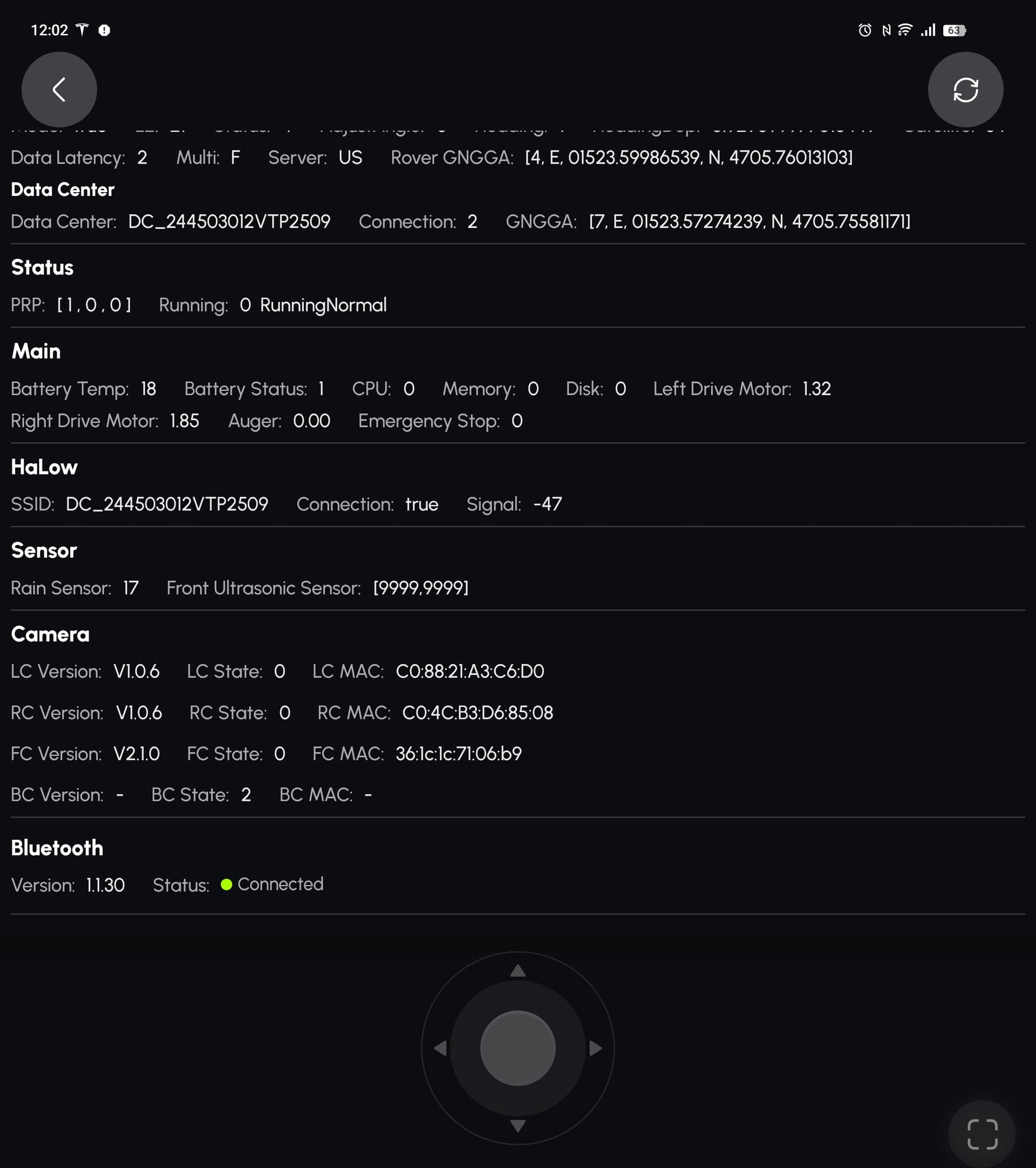

Sonsor is reading between 15 and 25..

@tano The problem the sensor always reads low if it’s slightly dirty - mine is <200 despite raining for two days, and the “don’t mow!” threshold is 1000. I just cleaned the sensor a few days ago – it’s already dirty enough.
Even if you clean the sensor and get 2000 from it (which I did), it will dry out FAR before the grass. So, in practical terms, the sensor really isn’t viable, at least for me. Instead I use my Mowing Operation Initiation Slipper Test (MOIST) – I walk in the grass and look down at my footwear.
I’ll be using the scheduler and turning everything OFF/ON manually. No biggie. They really need to create or integrate with a grass moisture sensor (not soil, grass, which you can probably build using an Arduino but need an API to talk with the rover (may get API access someday, they’ve talked about it, but it’s not high priority AFAIK)).

The sensor threshold for the 24 is now actually 500.

@bryan.wheeler I tested it a few days ago. My rover went out in the rain to run a Work Plan I started manually at 995 or something. It didn’t if the sensor was >1000.
Easy enough to test.
  1. Clean the sensor thoroughly. I used Simple Green and a paper towel.
  2. Rinse, leave water on it.
  3. Check the sensor value. Ensure it is >1000.
  4. Start a Work Plan. It shouldn’t go.
  5. Wait until the sensor is <1000. Start a Work Plan. And away it goes. Well, it did for me.
Weird because they said it should be 500 now. Maybe there is a calibration issue with the rain sensors that aren’t functioning properly.
We’re sorry for the confusion and apologize for the earlier miscommunication. After confirming with our product team, the trigger value for the rain sensor is currently set at 1000. We also understand there have been some issues related to the rain sensor, and we are actively considering ways to optimize its performance. We truly appreciate your continued support.

I believe the rain sensor is basically measuring conductivity. Water that contains ions conducts electricity well, but pure water does not. When it rains here my sensor reading is about 30, not enough to stop mowing. When I poured well-water onto it the reading shot up to 1274 because the ionic content was high. They must have developed and tested the rain sensor using tap water instead of distilled water. Has anyone tried taping a piece of rusty wire next to the sensor to see if the metal ions would help raise the rainwater reading? Any ideas for other slow-dissolving ionic aids that might work?
