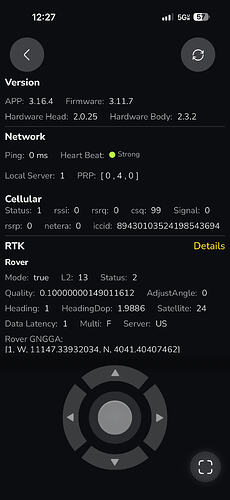

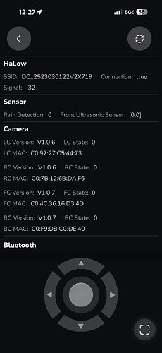

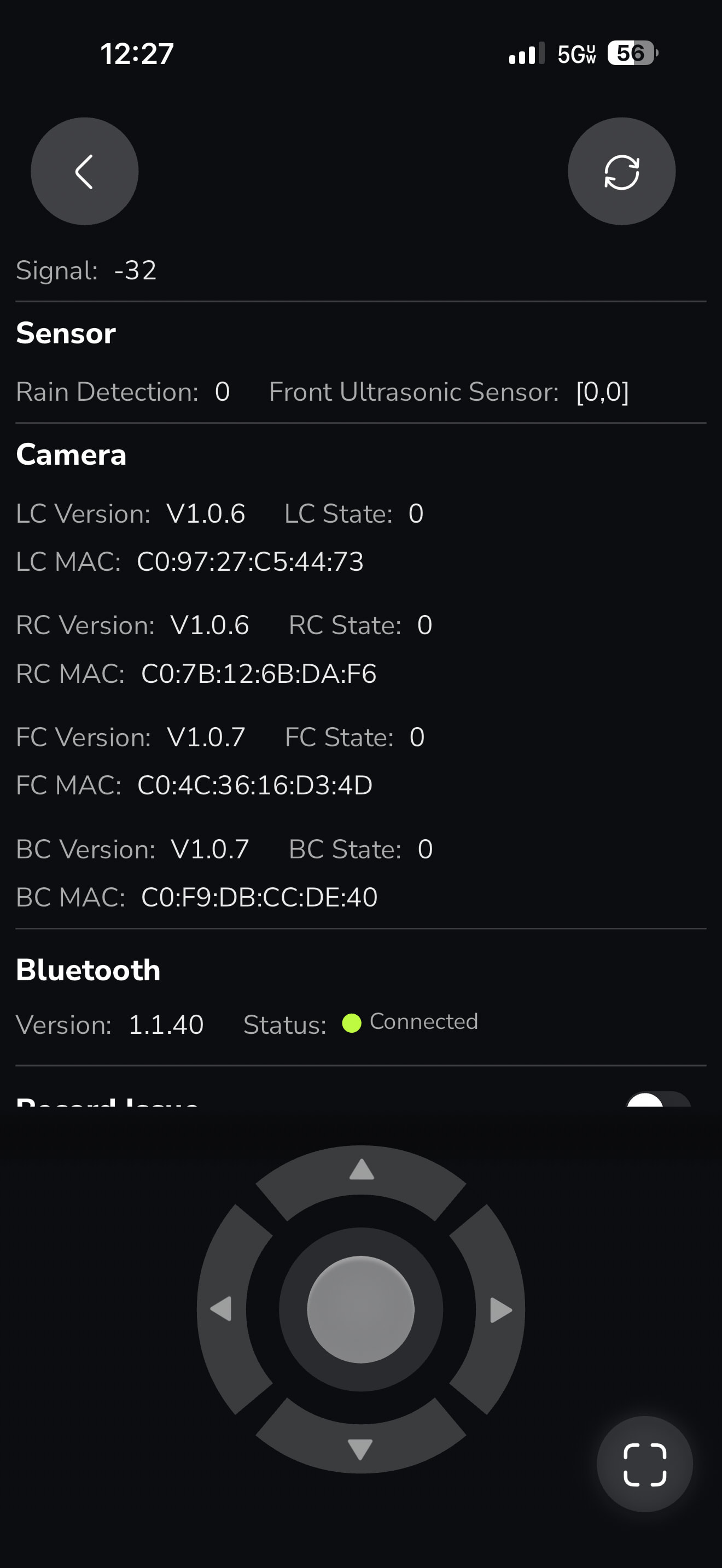

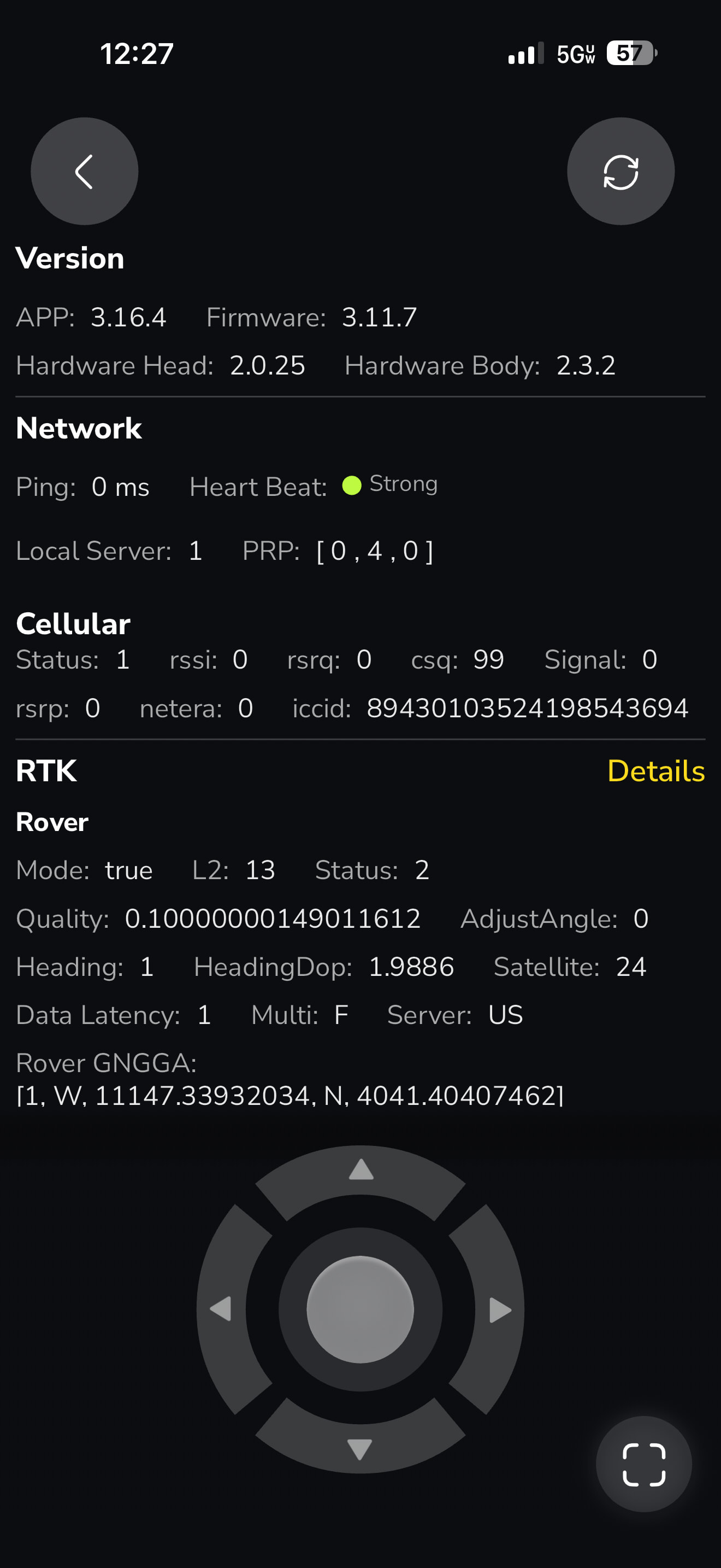

Gotcha, here you go!
Yep - just what I suspected. Connection 3 means it’s in local HaLow mode. This might be part of your issue with mapping and is certainly why you can’t connect when bluetooth is disabled. Also explains all your network issues. Bluetooth can be a little spotty especially with certain Android phones.
Lets’s try this. Unplug the DC for 5 mins. Also unplug the battery cable to your core for the same 5 mins. Power up the DC and wait for it to go green. Once up, power up the core. Then check the diagnostics for Data Center Connection. You want to see status 2, which means it has internet. Then you can try to map with bluetooth off again. IF it still is 3, a solid 3 (flipping between 2 and 3 is normal), then check and make sure you see connection on your UniFi equipment. It needs to be FastEthernet (100Mbps). It won’t work on Gigabit Ethernet only ports. Also make sure your firewall isn’t blocking anything from the DC or the Yarbo Core (which connects through the DC). You can refer to this wiki article for more information. HaLow Disconnects While Data Center Is Offline (DC Connection = 3) | Yarbo Wiki
