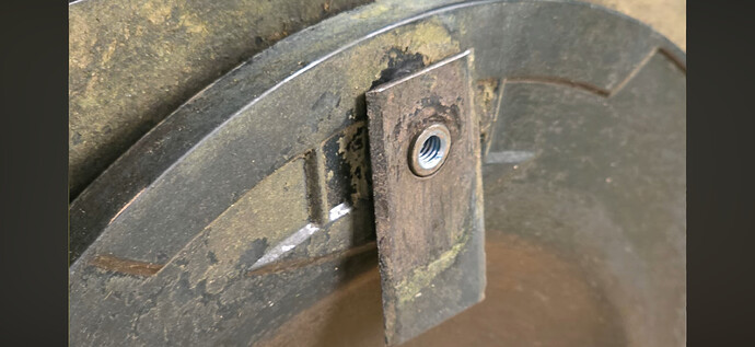

I have an M1, and the disk design is such that the razor blades freeze in place after an hour of mowing my lawn (and right now, it takes 40 hours of mowing for one pass on my 1 acre). What is the point of having blades that fold back for safety if they are stuck out in place? It might as well have a rigid blade, though a metal blade like the Pro might not be good for the M1, since it is two blades vs five blades. The key question is, do you have a design in the works that has a priority of keeping the blades freely rotating? Can you share the design approach to make this work?
Q: The blades usually get stuck facing out, so they’ll still cut. If they did hit something, wouldn’t they be more likely to spin/flail, even a little, despite some grass being jammed in there? That’s what I’m thinking.
Yes, they are stuck facing out. However, when I have tried to move them around in a circle to clear the grass clogs, they are very difficult to move at all. If I did not have cut-proof gloves on, it would not be possible without cutting myself badly. I found it quicker to remove the disks, then remove the blades, then scrape out the grass with a flat-bladed screwdriver. Obviously, I do not want to do that once an hour. I just pretend that they are meant to be rigid blades until it is time to replace the blades. When one side of the blades are worn down, I swap the disks with each other to get the other side of the blades exposed for mowing. I have a second set of disks all cleaned up with new blades when the time comes for new blades. They actually last longer than I expected.
This is normal for them to stick out and get grass stuck underneath. All manufacturers who use these razor blades design have this “issue”. But, it’s not an issue if they are stuck out, only stuck inwards. Trust me, if it hits something hard, it will give and spin.
I did see a video recently of terramows design and they have a smooth raise tube that the blade hole fits over and the screw head holds the blade on. The YouTuber said this seemed to eliminate the issue. One of the PPP was using washers and different screws and said it had a big difference. Maybe give it a try and see if that helps.
I tried putting #6 flat washers under the blade yesterday to see if that would make a difference. It still lets the std screws go in far enough to engage the tread lock compound. However, it made no difference. Not high enough to change things.
I think the Yarbo design error was putting the support ribs on the blade side of the disk. They make it easier for the grass to pack in under the blade. It might have worked better if the ribs were on the top side and the bottom side had a little more of a raised pad. Then, if the blades had a rounded or 45-degree cuts (like I have seen on other blades) at the back to make as small an area for grass to pack in between the blade and disk.
The design in your picture does not let the blade wobble much. Perhaps the ability of the Yarbo blade to move around so much also makes it easier for the grass to wedge in. I noticed that some of the impacted blades were cocked at an angle do the the grass wedging in.
I also remember somebody mentioning another disk design where the blades were sandwiched between two disks. They thought it fixed the clogging issue.
My understanding is that the sandwiched disc with the friction plate protecting the blades also led to a poorer cut.
