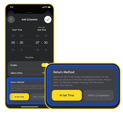

Flexible Return Options for Mowing & Snow Blowing Schedules
Your Yarbo just got smarter! Now you can decide how it should return when following a schedule:
  • Return at Set Time :alarm_clock:
    Yarbo will return at the exact time you set, even if the task isn’t finished.
  • Return After Completion :white_check_mark:
    Yarbo will keep working until the job is done, even if this goes beyond the scheduled end time.
You can easily switch between these modes in the Schedule interface.
