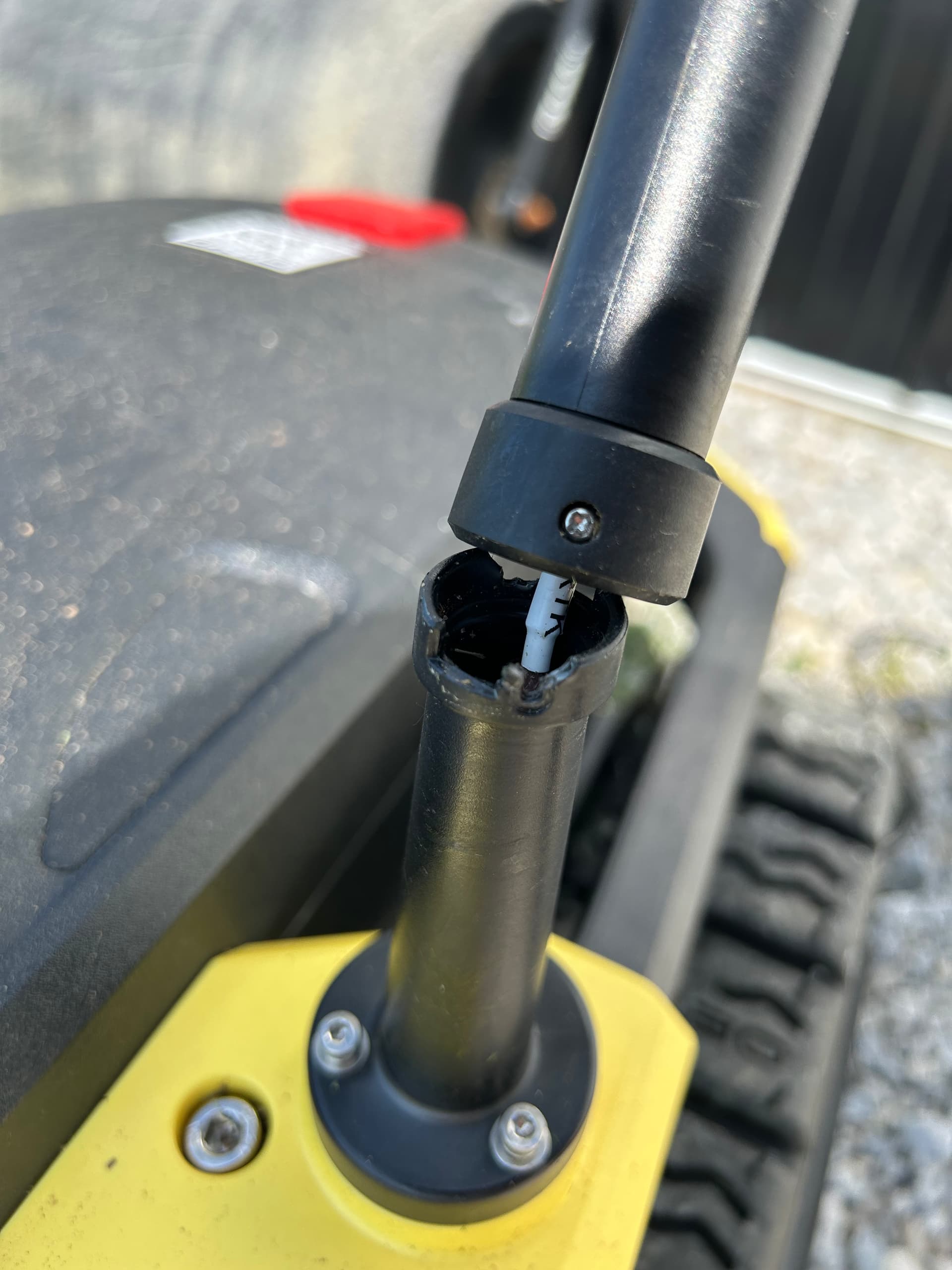

Joining the party of broken RTK antenna.
Need to open a ticket still but man it sure seemed like it took no effort at all for it break off. And it just broke the lower section right at the screw holes. Which I’m guessing just sitting out in the sun is going to make it happen more often. Plastic like this tends to get brittle sitting in the sun. Flexible would nice, but I’m sure would cause issues in the math. When I found the top section hanging, yarbo was still mowing but if you look at the lines in the yard it was drunk. Missed sections not straight, you can see a distinct difference from before and after.

I’m sorry to hear about the issue you’re experiencing. I’ve checked your support ticket, and the replacement parts have been shipped from our side. You can expect to receive them within 3-7 days. Thank you for your patience!
Yep, that’s the fastest support has replied and acted so far. Attached a picture of how it broke off. Screw holes just popped.
@tallman.brew If you have the shorter mounts you can remove the tall, and replace with the shorter RTK. Just screw the top part off the above the screw that broke. I only use the top shorter ones anyway. Mine is a 2024. It came with the shorter mounts. They were in the box with mine. All I had to do install short mounts, unscrew top, then screw down to short mounts. Tall was for winter I think I remember reading. It could get you by until the new ones come in.
When my short one broke, I used my long one until the replacement arrived. Good to have spares.
