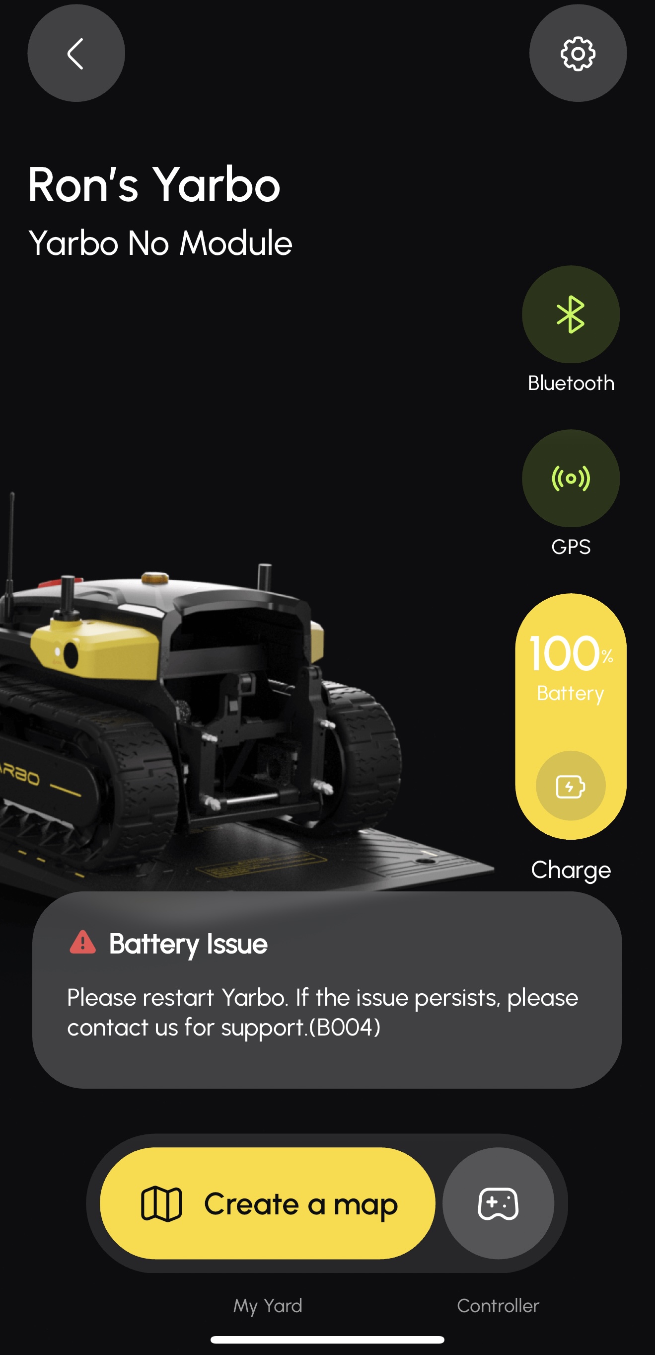

I just got a message that stated battery issue. Said to restart and I did. Now it doesn’t recognize the mower module is attached.
Shutdown the core in the app and then pull the battery cable for 5 mins. Sometimes it may not be fully seated. I’ve done it once. There are some communication lines in that cable that might not be making good contact if so.

Well i tried what you suggested and that didn’t work. I even powered down and let it sit with battery unplugged for a hour. It doesn’t recognize any of my attachments. The cameras don’t work, the speaker doesn’t work. The only thing it will do is let me drive it around manually.
Well, that is not good. Sorry to say but this definitely needs support to diagnose it. Sounds like maybe a bad battery, but they will have to see what they see in the hardware diagnostics. Have they been in contact and or diagnosed it yet? Will it charge wirelessly on the dock? If not, I recommend connecting the wired charger and leaving it on so they can try and remote diagnose it.

I drove it to the docking station manually and stated charging that way. I attached the SAM so they could run diagnostics. I also sent them pictures of the wiring and the circuit boards. Nothing looks burnt out to me, but it could be a small component on one of the boards.

Yes, my power module went bad. They replaced the core. I actually received the core yesterday. They did a backup of my maps today, and hopefully when I power the new core up all my maps will transfer over.
