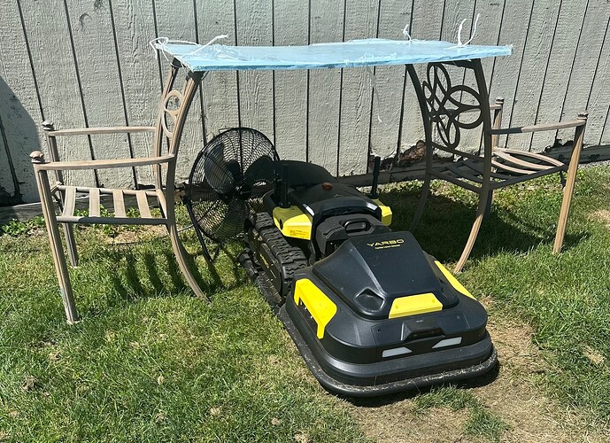

Well, here’s my temporary solution. Foam board tied to patio chairs, battery cover off and industrial fan blowing in the battery compartment. Barely holding on but stable at 49 C with ambient temp at 98 F in the hottest part of the day. SOC up to 72% still charging.
Update: I made to 80% with this configuration before I sent it back out do what what I paid $5K for. We’ll see if the battery survives the summer.
The battery is sealed in a metal box with no ventilation. That box is then dropped in another box with no ventilation. The key is to wash the thing with massive amounts of air to dissipate the heat. There’s no way this was tested in the summer conditions or this problem would have been immediately apparent.

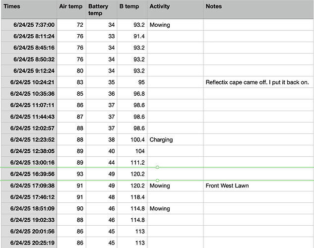

@Wes I did manage to charge and mow all day today. High today was 95. I was able to charge in the hottest time of the day.
I believe the prototype is a success so far.
Tomorrow’s high is forecast to be 89 but we might get some rain.
Here is today’s temperature data.
The highlighted row shows the 93 degree temp and the battery was charging in full sun with the reflectix in place. Max battery temp was 49 (120.2)
I’m going to leave it in place for the foreseeable future.
