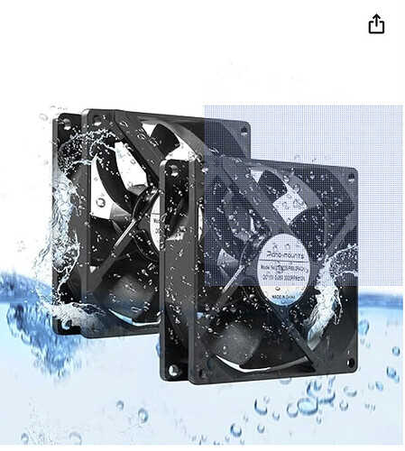

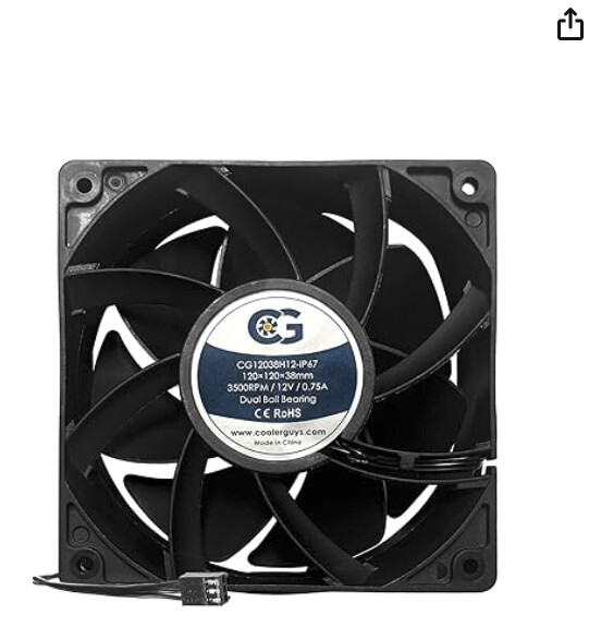

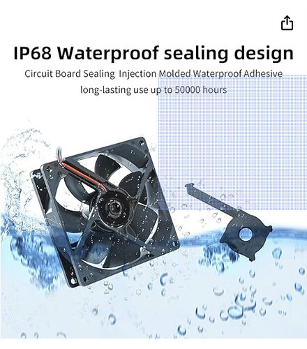

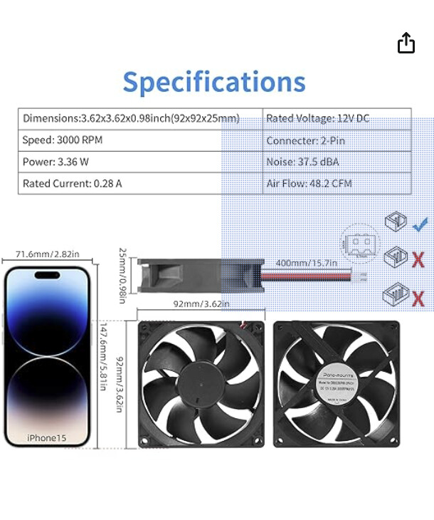

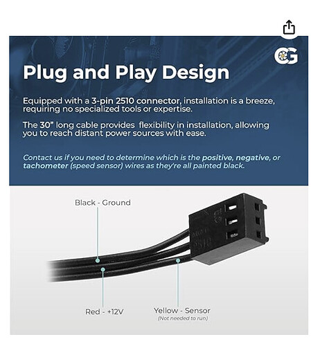

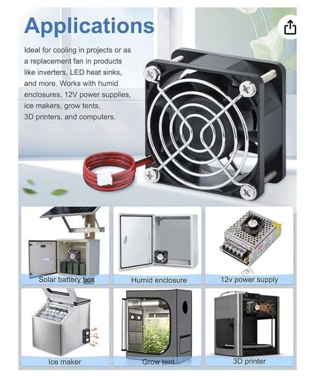

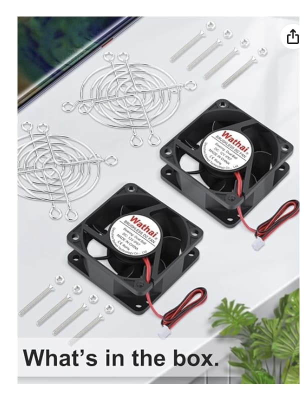

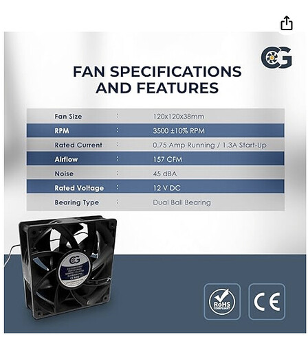

How about some more ideas? I’m looking at some fans, maybe Yarbo can think about adding some internal fans? :thinking:
Hope this helps someone. Multiple sizes to fit.

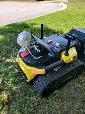

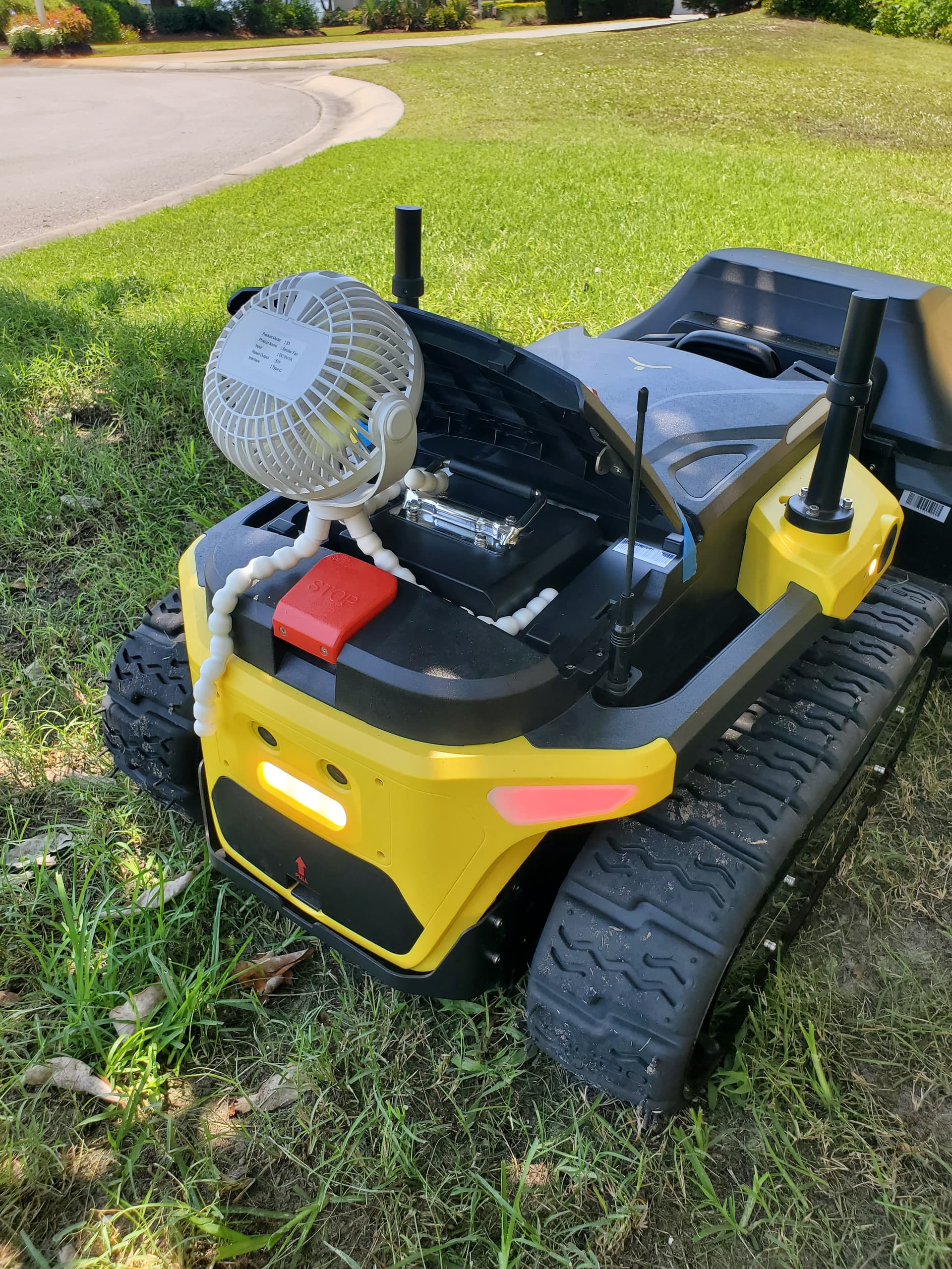

Seeing how this goes. Climbed from 35 to 41 C. Strapped this on and the painters tape held through the roughest part of the zone. See how it does. Heat index of 97F, 87F with high humidity and only light breeze. We’ll see if the humidity gets the better of the tape.
Just an amazon “usb stroller fan” my wife bought years ago. It was so useful I bought a bunch. Great for boat bilge work or to mount under the t top. I use to keep help my NAS cool when its cooking on a big transfer.
it lasts about 8 hours on low. I have it on medium for this mow.
Started waffling between 40/41 C but now holding 40. This zone and cut direction have tons of turns and short runs so the motors are torquing frequently. Would be nice to see it in the high 30s but with these conditions I’m not sure what more it can do.
