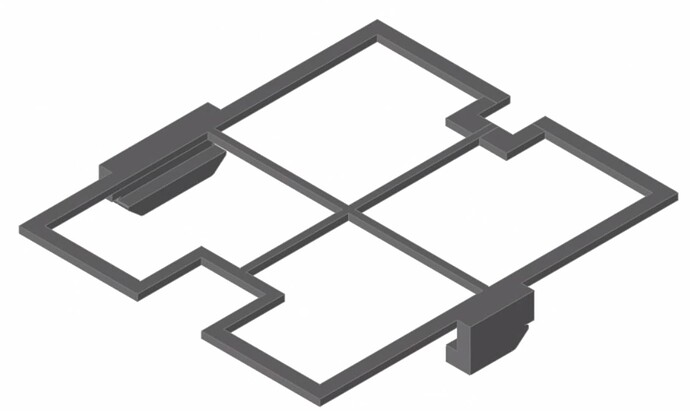

Or maybe someone can design a 3d printable replacement
Not so subtle endorsement of the idea! Lets see it!
However, it might be faster just to print our own. Not sure how many extra units they have laying around for warranty.
In the process of printing up my prototype now. Intention is to glue reflectix down across the top and then the side pieces clip in around the battery cover holes on the side. May have to make some adjustments after the real thing comes out … only so much you can do with a tape measure. The shorter side on the right is to fit around the HaLow antenna and the front/back slots should give some room for the stop switch and orange safety light.
Love it!
@Wes @ken.w.gregory I would be cautious with the reflectix as it may bounce the GPS signals and make things somewhat worse. Some white non-reflective material might be just as good.
Yea I thought about that too. Ken indicated he didn’t see any issues and I haven’t gotten it all on and working yet to test. The other alternative is to ground the reflectix or use another insulator on the same design - easily put on and off.
So far I haven’t noticed any changes in GPS behavior. It might be better to use a foamboard or something though. It’s easy to take on and off, but I will say I’ve found it useless to use it only while charging… I think the only reason it helps is because it keeps the solar heating down while it’s out mowing giving it more headroom when it does charge. The better solution would be another RV style weather sealed fan that vents the heat off the battery - would be a nice thing out-of-the-box as a Yarbo solution, but even if could buy another cover to modify that’d be nice.
I looked at possibly 3D printing an alternative cover. There’s some complex curvature to the cover to make it match so it’d take awhile to really get the measurements right.

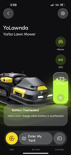

App 3.15.4 is now reporting the battery temp error. The error appears at 48 C, but it keeps charging until it hits it the 51 C hard cutoff. I’m still on 3.8.18 firmware.
That’s progress.
Well, looks like it’s half fixed. I drove off to swap the discs today. When I told it recharge from the controller, it returned to the dock to report the misaligned error. The battery was hot and I knew it.
So… If charging is in progress and it overheats, the correct error will display. If it returns to the dock already too hot to charge, the same misaligned error is reported.
Someone with the new firmware will need to confirm this behavior since I still don’t have it. I’m going to hold judgement until it’s confirmed.

So I have a question: When you get the battery overheat alert, does it persist and need to be cleared in some way? Or is it supposed to go away on its own?
Here’s what happened last night: Yarbo was out mowing in the dark (VERY AWESOME!) It was someplace in the high 70s, (it was a pretty big cut, and required a recharge in the middle, which is why it finished in the dark.) As it got to the end of the cut I got the battery overheat alert. But after Yarbo went back to the charger, it actually started charging (according to the charge indicator.) But the overheat alert said it wouldn’t charge? But it was.
When I got up this morning, Yarbo was fully charged, but the overheat alert was still up. I tried restarting Yarbo, but it remained. Eventually, I disconnected the battery, which ended up clearing it.
So my question: is this an expected behavior? Or is there some action, short of pulling the battery, which I’m supposed to perform?
