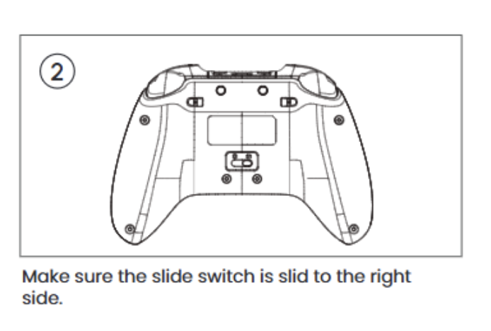

@Frederic also make sure the switch on the bottom of the controller is not set to phone mode.
Reference support article.

Yes Bryan, the switch is still in the controller position, not the phone position.
