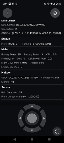

What does your diagnostics screen look like? Specifically the Rover, Data Center, Status, and HaLow sections? You can omit the GNGGA GPS location information.
Brand new unit that has yet been able to even complete it first job
I Could Careless about my GPS Location
and the distance from the DC and it is stil lost
Your L2 satellites are extremely low yet you have an RTK status of 4. I suspect you may have a bad RTK antenna or it is loose. Try swapping left to right and right to left and see if the L2 satellites increase.
