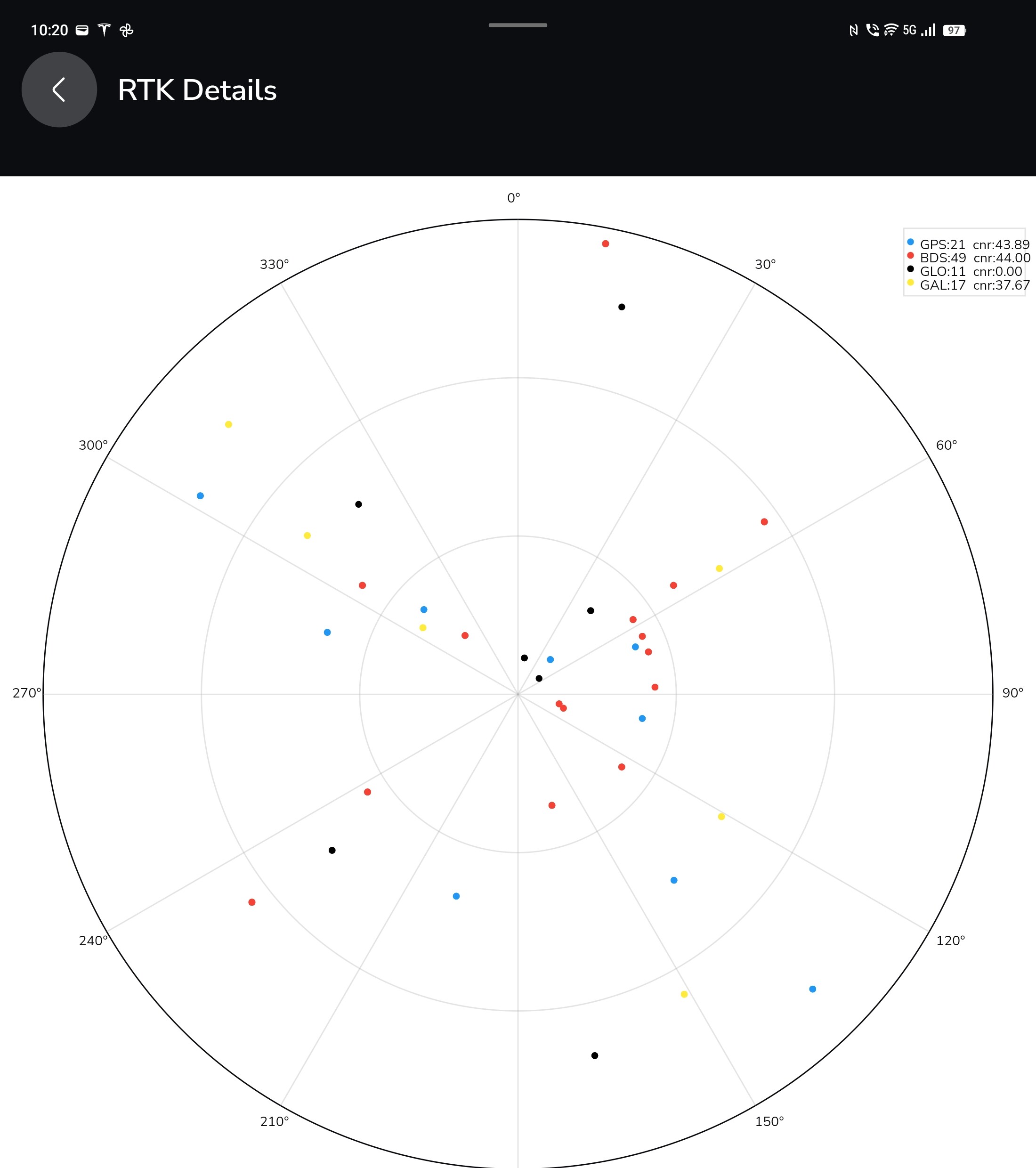

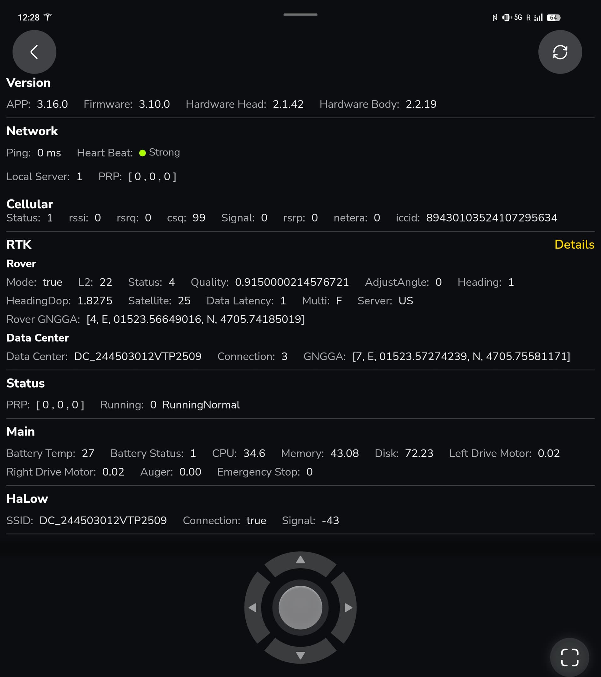

But I of course am interested in finaly resolving my problems,so I moved yarbo out in the open. And activated issue recording.
Is the data center connection 3 all the time or does it switch to 2 as well.
Have you tried restarting JUST the core or JUST the DC to see if it recovers? It might help narrow things down.
Your heading dop is extremely high. 2 is unusable. It should ideally be less than 1. It’s not recommended to correct map drift as an example unless it’s below 1.4.
There is a big solar storm going on right now too, so maybe that’s a factor here in this screenshot at this point in time.
It is switching continously.

So your HDOP is always that high at your dock?
