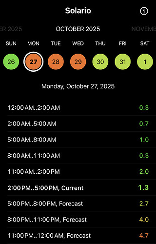

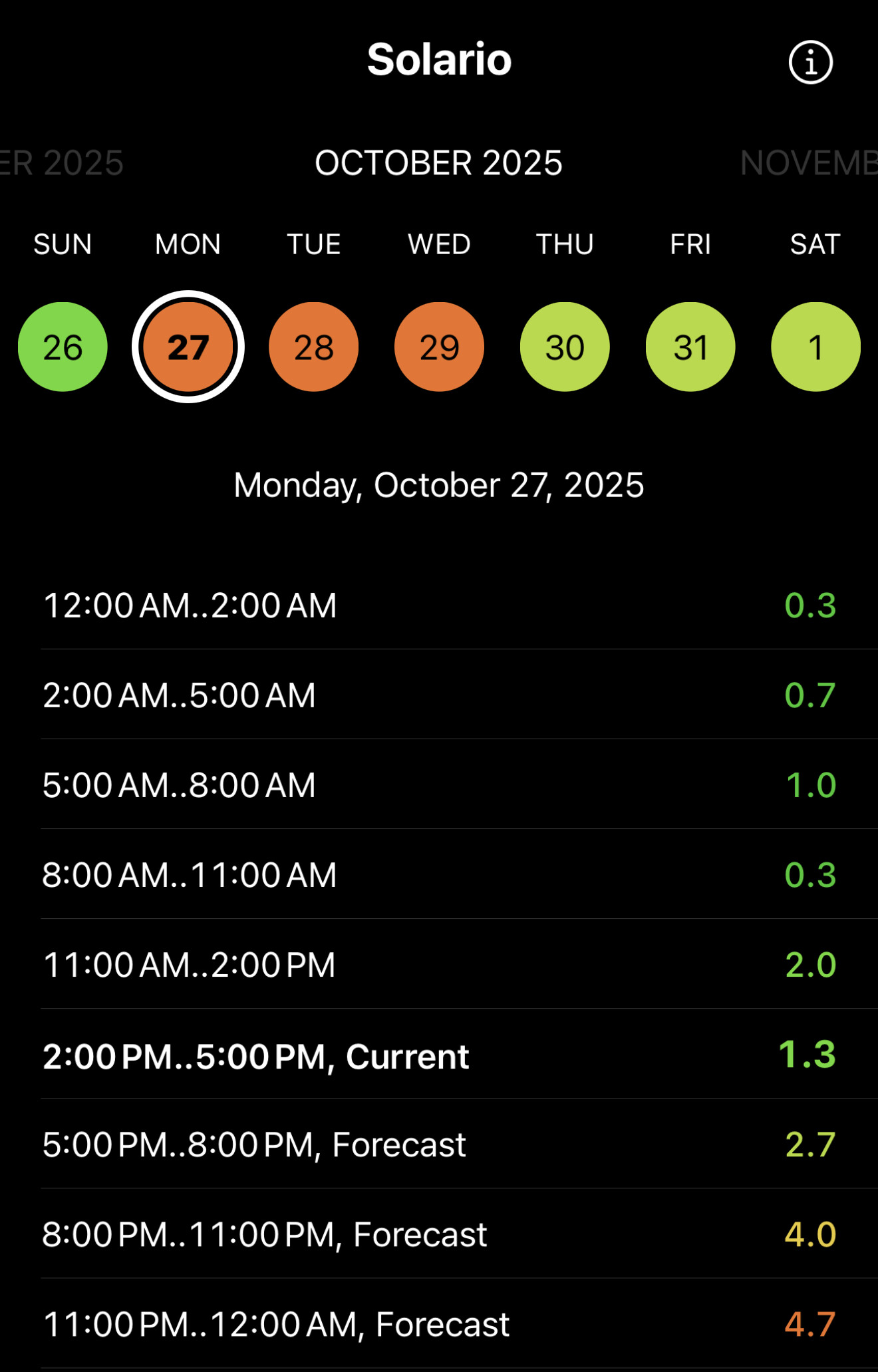

Saw someone mention in the FB groups about not having GPS today and another replying and saying a solar storm is in progress. Decided to go see if I could find an app to track this. Not sure when you tried last but looks like it’s getting worse today through the next few days and was fine yesterday. Don’t know if this correlates, if the app is accurate, or if it is even related to your specific issue. But I offer it as a data point.
This started at 8AM. I am guessing the person saying that is the same guy I have seen that anytime someone brings up GPS he says its solar activity. NOAA does not have anything that is affecting us. I wish this was the case - at least it would be just a day every now and then. This goes on very regular. At least 2 or more times a week.
