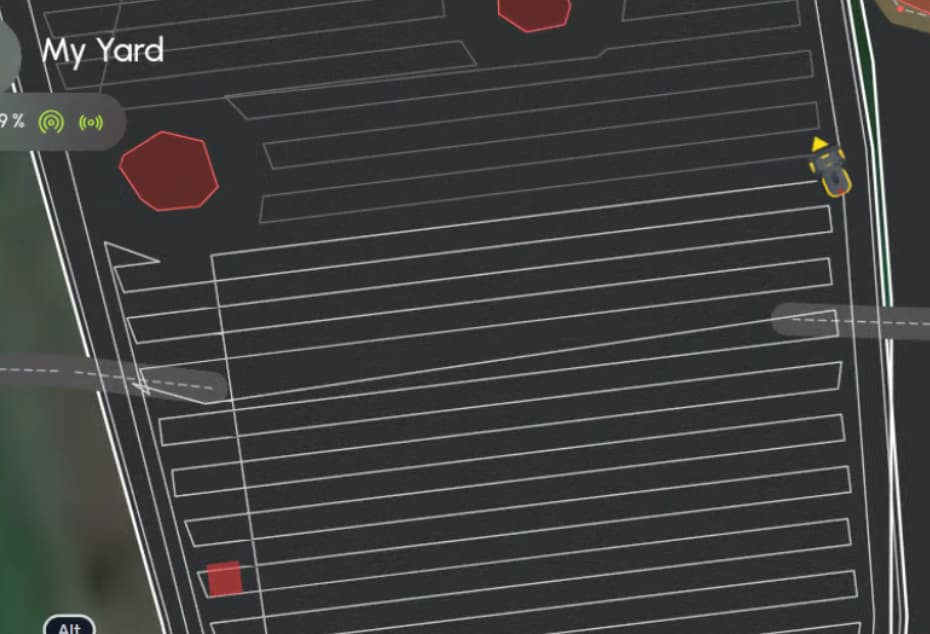

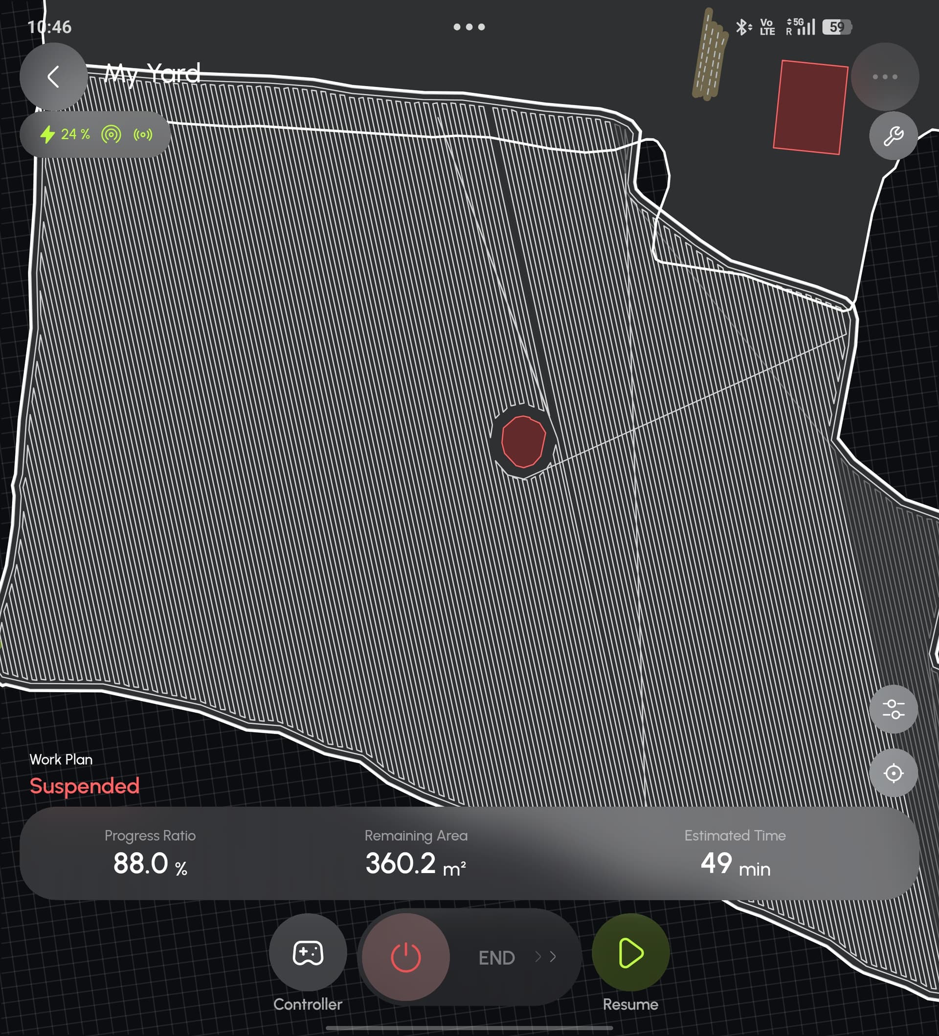

After receiving my new core and running it with latest firmware available today 3.9.29 and with Android latest application 3.15.6 I have the mower leaving 1-2 lines not cut. I have it running everywhere on gentle contact and 20cm (8 inches) overlap. It clearly indicates it’s intention already on the map view before it heads out doing so. Pictures attached. Arrogant bastard!
I didn’t had this before. I have 7 different mowing areas and noticed this at least on 5 of them. 2 zones where I haven’t had this issue are tiny so maybe that difference here.

I have seen this as well. I didn’t get a very good screenshot. Or I would have opened a ticket.
It seems intermittent to me. Same work area different cut angle doesn’t miss any lines.
I’ll check again when It gets back around to this cut angle.
It’s a known issue they are working on. The support center will load in app but it takes a long time. I’ve heard up to 20-30 seconds.
Happens to me too on/off. When I notice it early in the plan I cancel and do it again. If it does the same thing I move the angle a bit and it fixes it…
I think it all relates to the routing optimization problem we report quite often…
I just set checkerboard and send it back out the next day. The 90 degree rotation gets it all

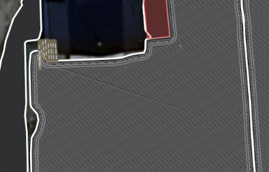

Here’s a good one….
Poor GPS area? Looks like it had a false good GPS lock and ended up in the NGZ and then plotted a path out.
I have not seen it recalculate the intended path after the job has started. Is that a thing? I’ve seen algorithm bugs that miss stripes, but this looks different.
Looks different to me too. Looks like it planned on doing that. But I’m no expert and didn’t stay at a holiday express last night either.
Yes, this is a thing. It snags the current path line to get out of the boundary if it’s slightly over.
Ok, I’ll take your word for it. It sure doesn’t update the map to the new path when it avoids something or gets unstuck.
Well, I stand corrected. It just did it for me. I think it might have something to do with recovery once leaving the boundary or entering a NGZ. In my case, there a pretty good downhill slope where it likely couldn’t stop and ended up outside the boundary a little. Just a guess of course.
Probably had a false status 4 and recovered. I see a cloud point further down. Was that expected there?
The lower red was track slippage due to the slope. Not unusual in that area.
