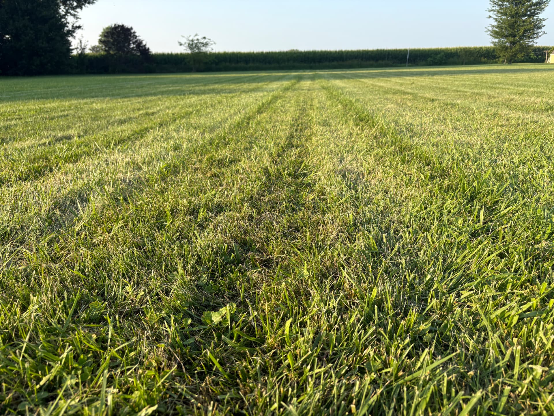

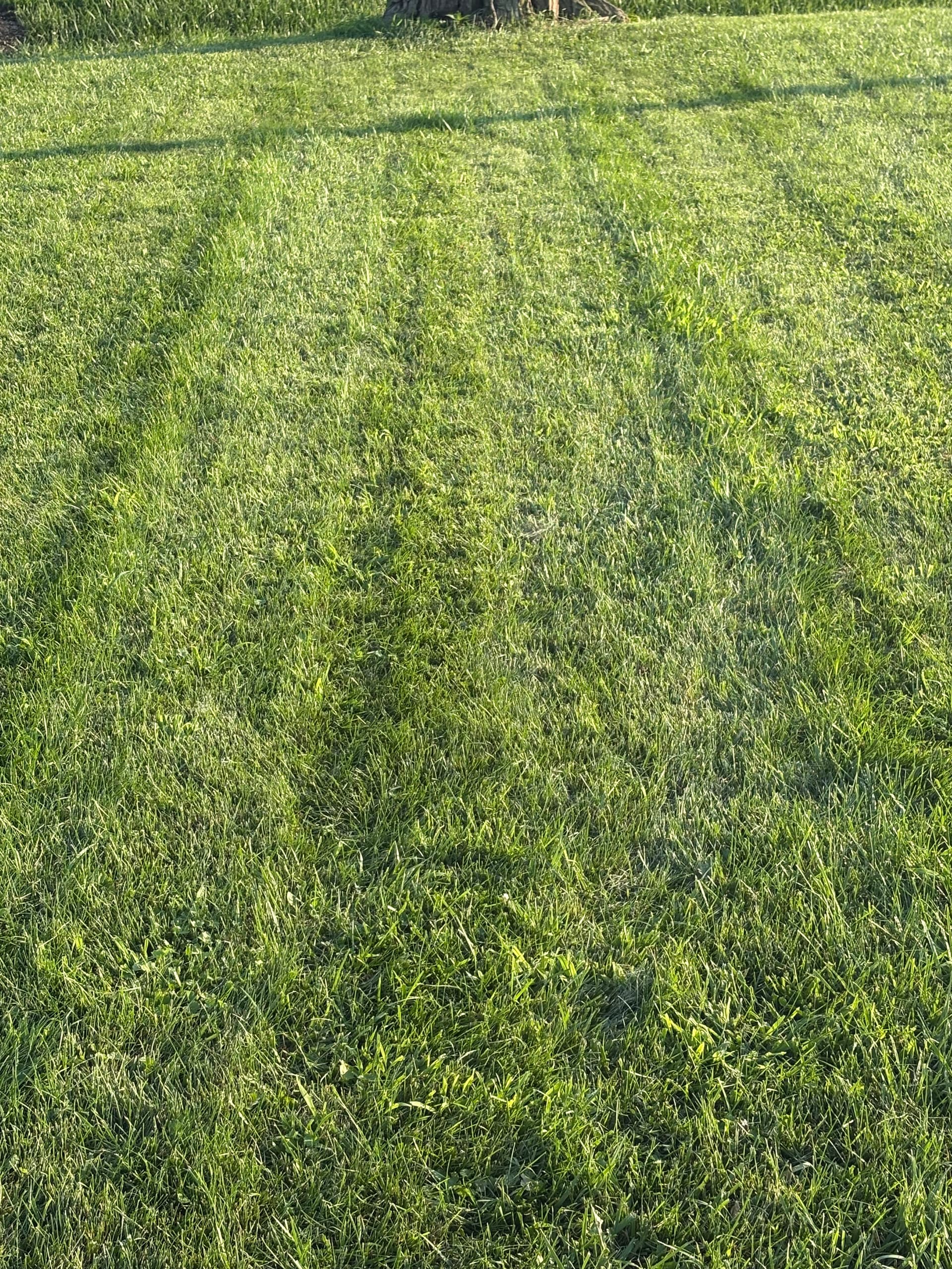

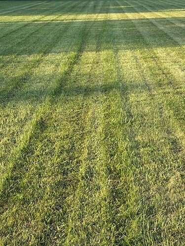

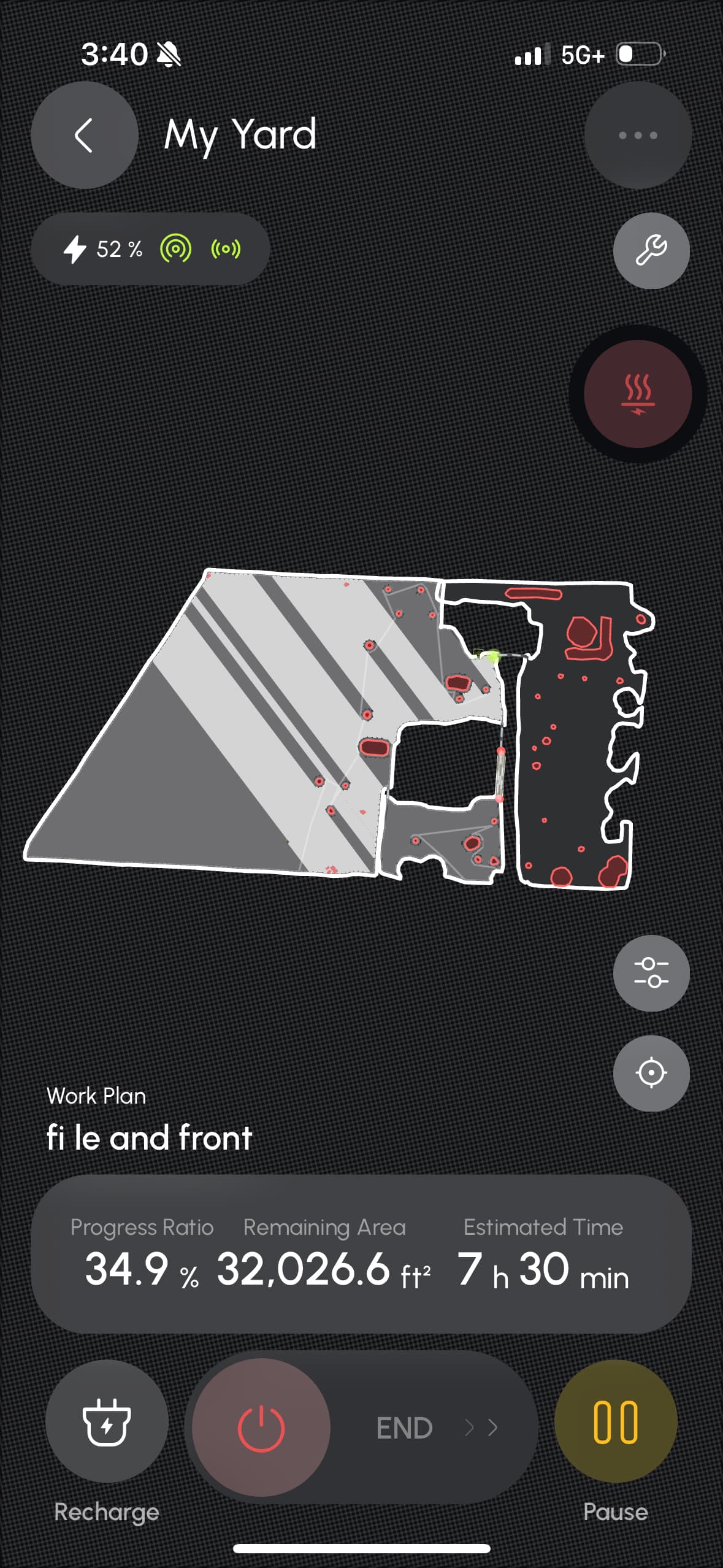

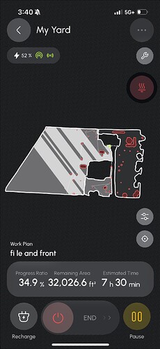

Hi all. I have the default 4 inch over lap and I do rotate. We have had a crazy amount of rain so it is quite tall. If you look at pics 3,4,5 you will note the missed paths is slightly smaller than the mower width and one it is evident off course. This part of my yard is over 1/2 acre with 0 obstructions. I do have moderate bypass on, but used advanced to put sensitivity to zero. I will try to split this part out and set to bumper mode to test. I do have no go zones. I came from 3 years of running a Mammotion Luba 5000 AWD. Concepts are similar. I will post my map. After losing an antenna on a pine tree branch I have been Leary of completely disabling vision.

During this mow today I again got a weird off path and a Yarbo sized path not cut.
Seems like this is not a normal experience? I expect the the small misses 2 in and less to some degree. It is odd as these are at least 16 in wide.

It is very hard to get it to show up in pictures. What the mower does is start on the right path but angles to the last mowed path, follows it then corrects on the return leaving a path mostly unmowed.
There are no obstacles and it was mowed just a couple days ago. Also it is now in the other direction than the first set of pics. Diamond.
It stops about 6 ft before the tree canopies in the back of pick.
What’s it avoiding? You can see in the pic it is a wide open field. Grass is all the same height, it was mowed just a few days ago.
I get avoidance in other areas it moves around it. These are about 180-220 ft long missed paths…

I will set to gentle contact in the pictured portion, but it does it in my more complex areas as well. The front and side. All those weird holes on the right are spruce and white pines on the edge of a corn field. I chose to boundary around them. I have various other things like gardens, flower beds, and many other trees - just bare in the field though.
