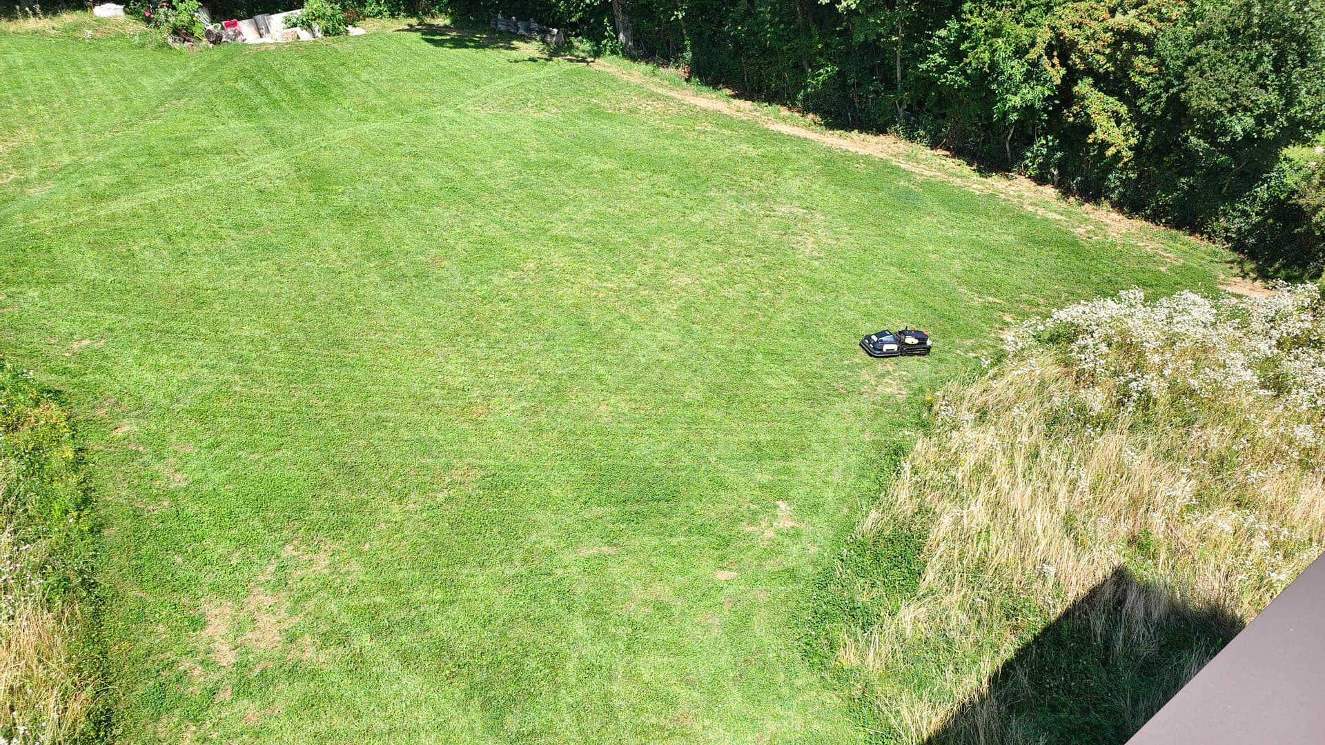

I could not have said it better myself. Support is so disappointing. For over 3 weeks I’m going in circles with my GPS issues. Ticket number is still #102036.
Always sending Pics and logs, they escalate but nothing happens, I change antennas from left to right. I restarted various devices…
In this situation yarbo came to a stop and lost gps, support is blaming the tree line (20m away) and yarbo is mowing from right to left I the picture.
I had a video call, the guy was not even aware of my ticket number, we startet at zero, 2½ weeks after me creating the ticket. So again me climbing the roof, showing him everything. He was not able to find aethimg walked over to a colleague. They restarted the DC and Yarbo, and told me all their data is fine, it worked for 7 hours, then the GPS problems came back again.
All I hear is that on their end everything is OK, but on my side it is not working as advertised, it is just standing under blue sky for hours of I don’t spot it. At the moment I’m yarbos babysitter.
Last advice was to disable Bluetooth on my phone, as my house is in the center of the areas to mow, everytime yarbo comes into the reach of my phone and the app is running it connects via Bluetooth. Which could be a problem, maybe, they think. For me disabling Bluetooth is not a viable option. (smartwatch, ear buds)

Is the yellow stripe at the top of your picture that seems to be around the perimeter due to Yarbo or it was already like this?
As for the GPS, you said you swapped the antennas. But did your try brand new ones? Sorry if I repeat myself (wrote about this a few times in other threads) my Yarbo was stopping under clear sky and acting oddly intermittently. Until I replaced the antennas with brand new ones. Never had a GPS prob since then (1 month now), except for rare transient pauses under very dense trees with covered sky.
May be worth a try?
