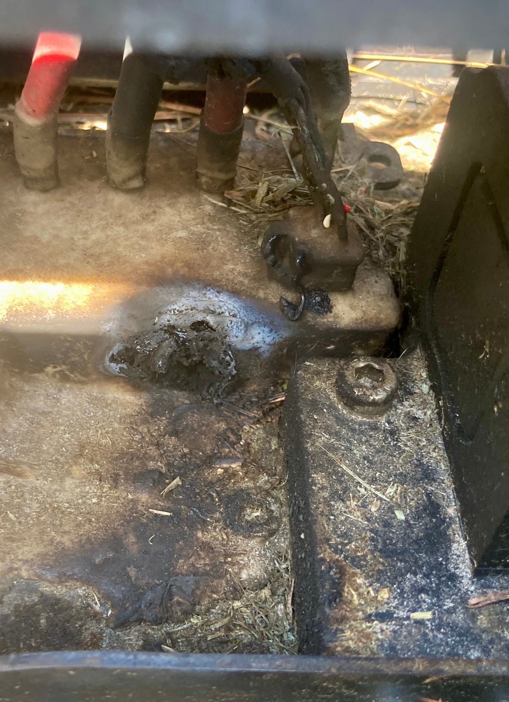

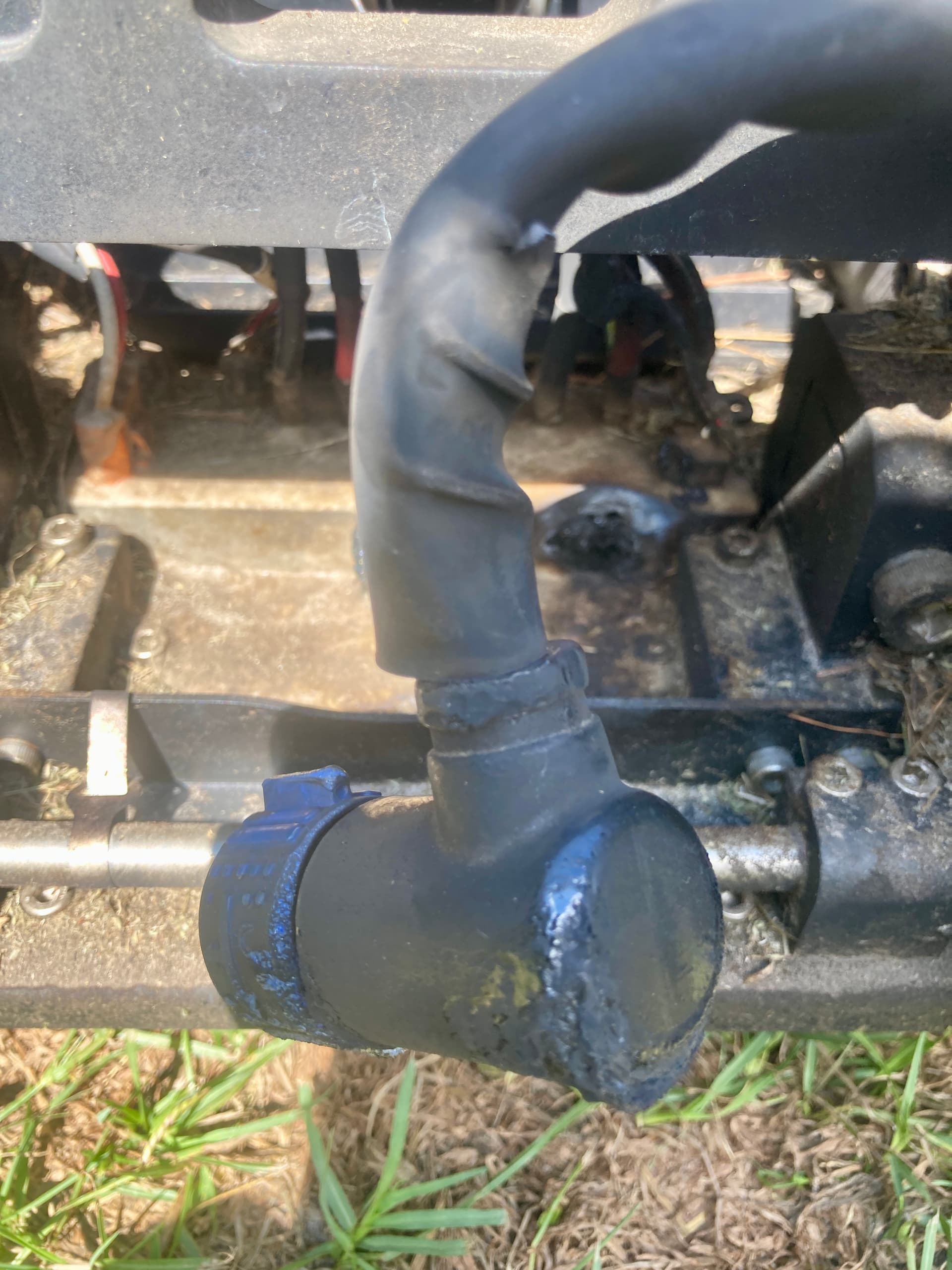

Well Bryan, I suppose the finger guards won’t be a problem anymore. While I was waiting on a reply, I put the original module back on, drove Yarbo out to the paddock with the remote to resume mapping and it burst into flames. So…no Yarbo now. I guess you cannot swap modules?
Oh wow! Looks like your power board fried. You can definitely swap modules but it’s recommended to power off when doing so (eliminates weird software glitches). But, I don’t believe that would’ve caused this.
It was off, the fire started when I pressed the power button :sleepy_face: Will it be covered under warranty?
Oh wow! Sorry you had to experience this
I can tell you, it was quite the shock. I’m saddened, because my Yarbo has always been a reliable workhorse. A week ago I received a Power Board Issue alert when I attached the Leaf Blower Module. Yarbo support explained that the problem stemmed from a malfunction in the module itself, the M25 connector cable wasn’t making proper contact, which caused repeated disconnections. Now I can’t help but wonder…could that flaw have been the cause of the fire?
