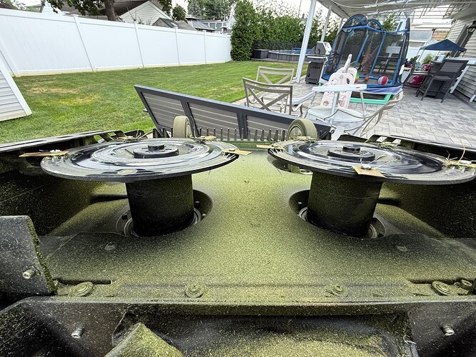

Cracked or broken mowing disk?
Thought the same thing, nothing. I did have random motor blocked warnings, but they were never blocked or had anything stuck.
I’m guessing you took that blade off?
It looks as if a blade is missing on the left disk. That might cause the disk to be slightly off balance. Did you run it that way?
Blade has been missing for about 2-3 weeks. I stripped the insert when I was removing the old blades. Disks spin freely without the motor engaged. No jamming up, no wobbling. Cut fine up to yesterday, mid mow, just started grinding away.

Stripped the insert
If a screw will go in you can use some loctite to hold it in. Had same thing happen to mine and it held. The noise is most likely from the missing blade. Quite a few people have posted about missing blades and that sound or blades getting stuck in and also causing that sound. I know you said it was not there before but maybe something hit and knocked something loose and caused it to become imbalanced.
I will try a new blade tomorrow. Thanks

You guys were right. Swapped the discs and put new blades, runs like a charm! I just have to spend some more time fine tuning. Or I’ll wait until the string trimmer gets delivered and map again and try to fine tune then. Thanks again everyone!
Awesome! glad its fixed. I don’t know at what RPM the blades run, but I don’t think it takes a whole lot for them to get out of balance. Then vibration ensues.
I did see a little wobble after I installed the disks, but it’s running flawlessly.
