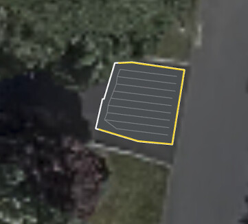

This design is perfect but turning at the end is a mess.

I think this sums up the turning problem well. It looks like to save time, Yarbo tries to shortcut the process by zero-turning without raising the module. All this does is dig a hole. When this is unsuccessful and Yarbo realizes it is stuck, it does back up, raise the module, etc but very often, by this time it is too late. It just got itself stuck too well. I may be misremembering, but I don’t think it worked this way last year. I thought it always raised the module before turning.
It’s just a little crazy because presumably, Yarbo has just removed a deep swath of snow, and there is snow yet to be removed on at least one of the sides. Why would it ever make sense to zero turn with a lowered module in this case? There’s more snow to blow. The ground isn’t perfectly flat.
