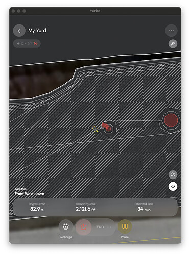

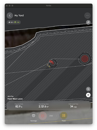

Working fine:

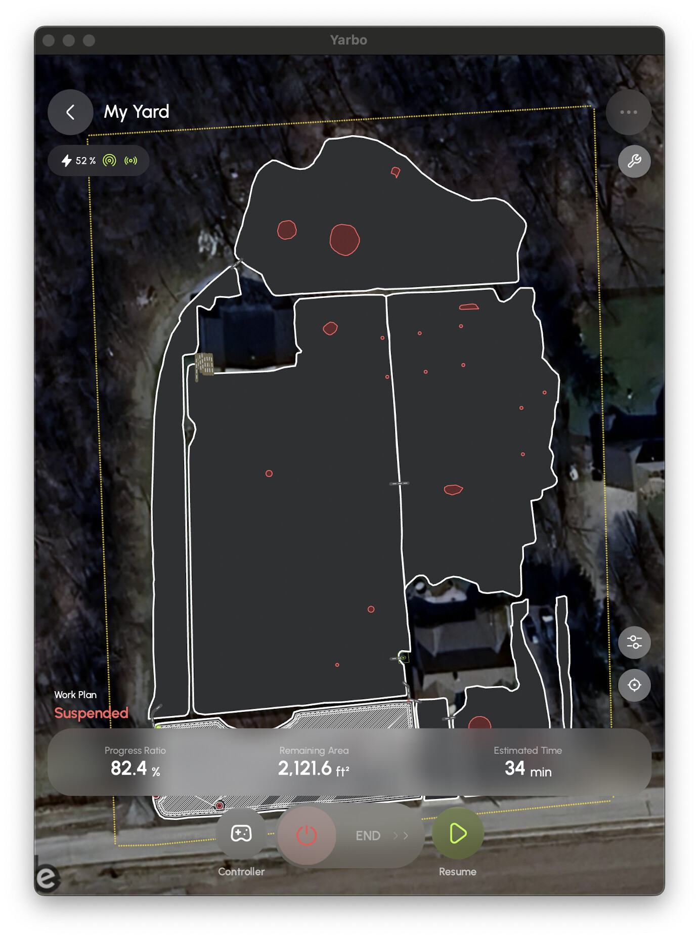

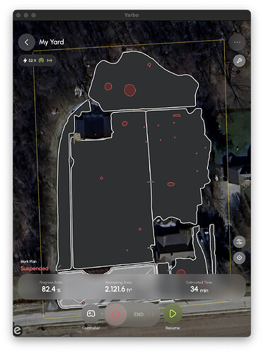

One minute Later. No HaLow or gps and battery grayed out.
One minute later suspended:
HaLow, GPS, and battery are all back. Something smells off…
should I reopen my suspended without cause ticket?
@Yarbo-Forum
Interestingly enough, I got an email from support about one of my other tickets at 13:14 asking me to keep Yarbo powered on and connected to the internet.
Do the workplans get suspended when support hops online to check logs?
That’s an interesting question. I’d guess it depends what they did. I’m not a big fan of support being able to access my equipment without me actively approving that access. They don’t know what you or the machine are doing when they start poking around. Maybe it’s on your new workbench for service?
