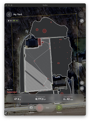

Did you ever can an answer to your suspended without cause issue? This has happened to me two days in a row now. Mowing fine then for no reason I get a suspended message and the rover stops mowimg. GPS and HaLow are fine. I press resume and it immediately resumes the job.

I had a second recurrence shown above in the screenshots. And have not heard anything since.
Suspended without cause happened again today at about 16:02.
Screenshot 2025-07-27 at 4.49.19 PM
Yarbo sat in that status for 10 minutes. Then the work plan was suspended. Coincidentally once the work plan suspended the Battery, HaLow and GPS all returned to normal.
Or maybe it’s the other way around. Once GPS recovered the work plan suspended.
either way… it suspended.
