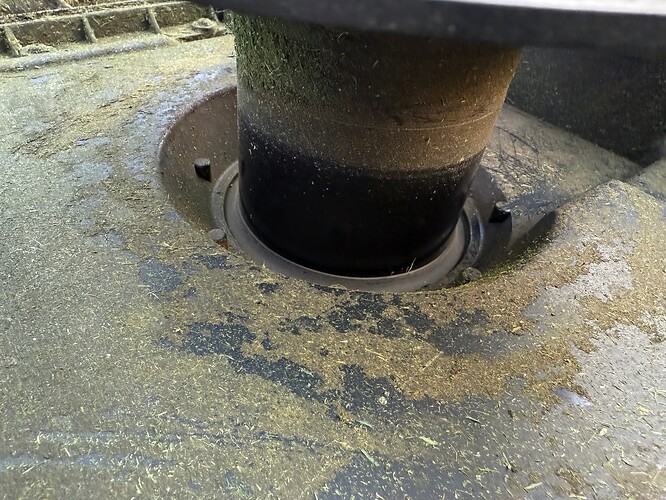

I did some cleaning last night noticed a good amount of build up on outside of the motor housing. This buildup is partially flipping the housing seal. I wiped the motor housings down with a rag as a precaution.
This all speculation, but I would guess debris could get swept off the housing on the wrong side of this seal when the motor is extending. I’m assuming there’s some type of screw jack with position sensors there. I’d bet this mechanism is not intended to be in contact with dirt and debris. The fact the motor retracts and extends on every docking would add to this.
Could this be contributing to some of the height errors when there’s clearly no blockage visible?
It’s possible but while I’ve seen buildup there I’ve not seen an issue otherwise. I’ve seen it trigger the error from buildup there though. You can usually raise and lower it a few times and clear that.
